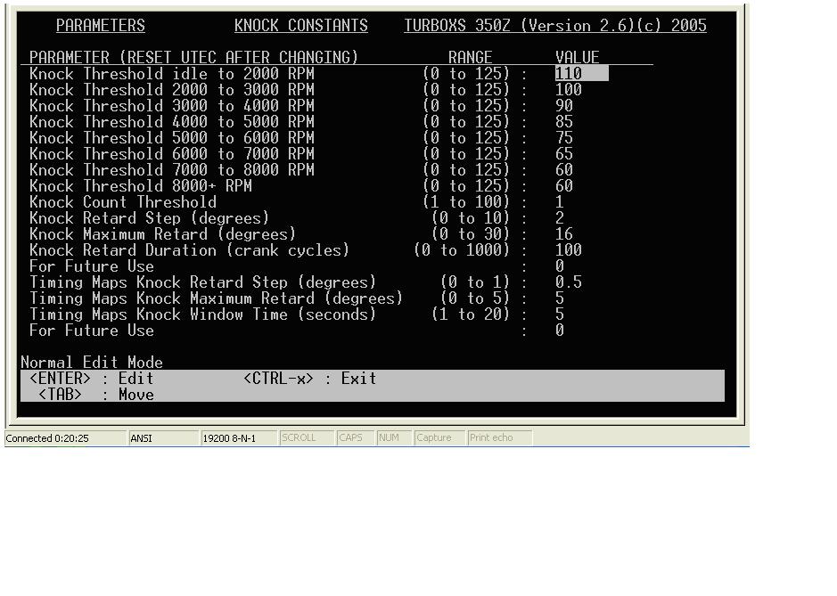

Here is a screen shot at what i have my knock constants set at now.
What should i have them set to?

i think mine are set to 100 90 80 80 65 65 65
your car was knocking at 05 i have had nitrous knocks and NA knocks but nothing ever past 01. even with the sensitivity all the way up at the base map settings..

I had some knock readings at 4,xxx rpm and around 6k so I started at 4k-5k and drop each sensitivity by 5. I still got a 01 at 6k occationally so I drop the 6k-7k another 5.

Right now it is
4000-5000 = 85
5000-6000 = 75
6000-7000 = 65
I want it to detect knock if there is some, so how far down can i lower this and still be safe?

That's probably something one of the professional tuners with experience would have to answer.
You could find a Sunoco with 100 octane. If that gets rid of it, it was probably a real knock. If not, its just engine noise.

After reading back through the manual, it looks like the UTEC detects knock and then retards the timing. If you have everything set to ECU the UTEC does nothing. Either i need to turn down the sensitivity or back down my timing at those locations.
Anyone else have any imput ?

Was able to fix my knock and timing retard problem. Car is running like a champ now. Here is what i have my timing set to now. Going to try and get some pulls on the dyno this friday.
3000 = 26
3250 = 26
3500 = 26
3750 = 26
4000 = 25
4250 = 25
4500 = 25
4750 = 26
5000 = 26
5250 = 24
5500 = 25
5750 = 24
6000 = 25
6250 = 25
6500 = 26
6750 = 27.5
7000 = 27.5
Later
Aceman
