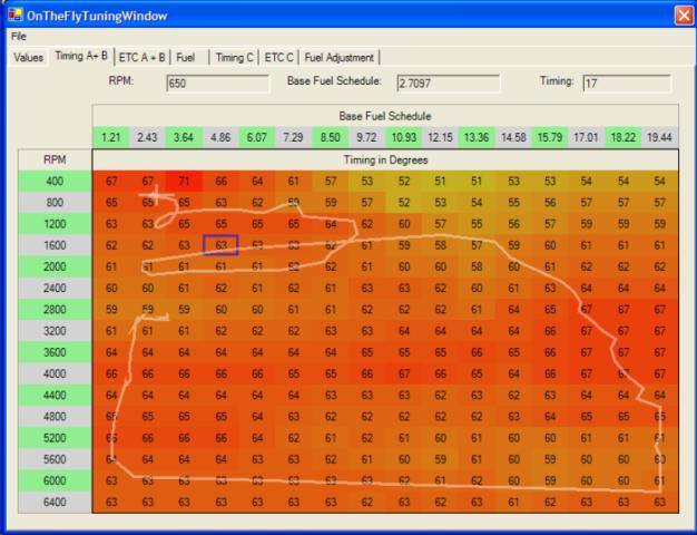

No, the ECU will run timing according to the timing map (see attached). The Base Fuel Schedule is a function of temperature and other variables (unknown to me).
Attached Thumbnails I just dynoed my car with Osiris.  Something strange is going on.-timing-trace-091207.jpg
