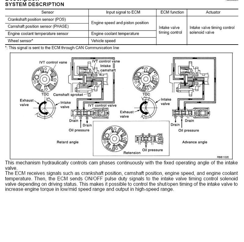

the Workshop manual.
what's the workshop manual? is this different than the service manual? I want one!!! Where can I get one?
Same thing, It's just a term us older mechanics use downunder
hmmmm.........my service manual doesn't cover the operations of the cam phasers.........and I have the service manual for the Z and the G.
My 02 manual describes the opperation in the Engine Control System page EC149

QuadCam's Avatar
QuadCam
Posts: 3,869
From: Vero Beach, Florida
thanks Nathan. I never to look in the EC section of the manual. I had been searching the EM and LU sections, thinking that it would be one of those.
anyways, here it is:
