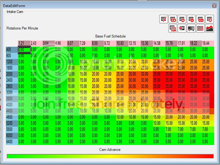

I had this saved - I think this is the stock map. (not my log but it might be helpful to you)
thanks rcdash
its the same, like what i have in my log.
cool so everything is fine
thanks again

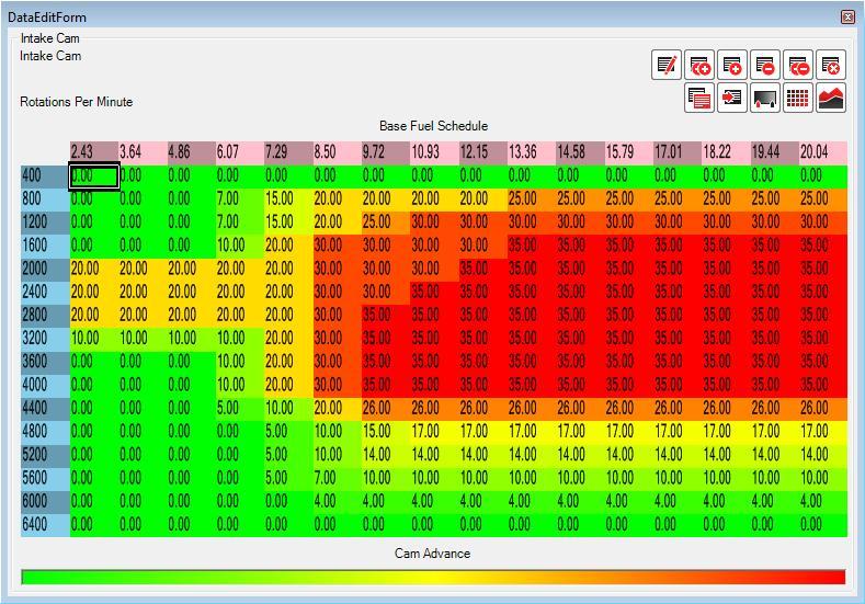

Here's what my stock map for the IVT looked like.
I don't have a log with it at the stock settings though. Mine will also show a slight negative when commanded to 0 at high RPM.
