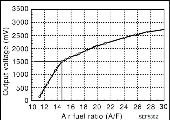

How my question, in LogWorks for my computer, I am able to custom write formulas to convert signals into something else. So:
- How do I convert MAF from g/s to PSI? (relationship between g/s and psi?)
- How do I convert O2 from volts to AFR? (relationship between volts and AFR?)

1. I don't believe you can convert grams per second to psi. G/S measures mass, psi measures pressure.
2. Does your Z have factory widebands ('04.5+)? If so, the FSM has a chart of a/f ratio vs volts. Or, you could get on a dyno with an independent wideband, and note volts vs indicated a/f ratio....pretty time consuming to completely calibrate.

I found the chart. Not the easiest to pull data from.
Attached Thumbnails Innovate Motorsport: OT-2-afr.jpg
