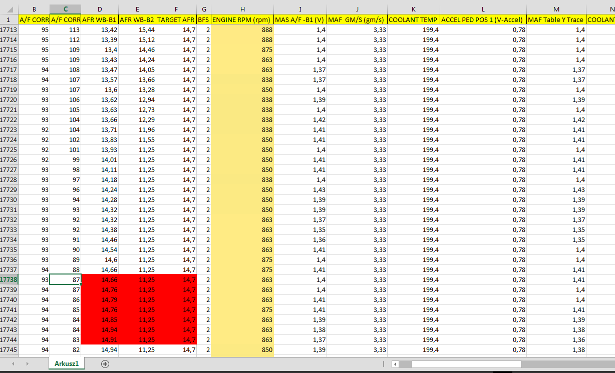

This log you uploaded looks like idle calibration and have a look at AFR bank 1 and 2 differences... ~14,7 vs 11,25??? It's not good. It doesn't show IGN TIMING values and top engine speed is 2500... it's not this what you mentioned before...

Bank 2 swing like this at idle/low load and I do not know why, new wideband and I also changed the cam sensors & check for leak.. i have brand new DW850cc but same problem with other injectors (RC650) ?!?
Every injectors have the same compensation (100).
Sorry, I posted the wrong log ...
You need to scroll up to line 7390 to see timing drop with big load.
46 isn't the degree of timing but burning time..maybe this is not the right mapping because i seen 2 different tuner but mapping are very similar..i can do new log just to show you but i have the same problem at high load since i have installed tt kit..same trouble with oem maf and i changed to Gt maf because they maxed out (over 4.7V)

First of all IMO MAF and fueling are uncalibrated...If you see AFR 11,25 your real AFR might be much lower...maybe 10...but your wideband is not able to measure below 11,25...check MAF table and injector settings like latencies and minimum PW.
Im not sure but some part of your logs show something like maybe clutch slip or traction problem...Maybe that's why ECU retard ignition in these areas and you cant calibrate this.
