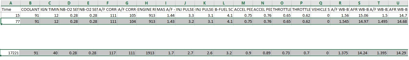

I have a 05 with front widebands, i bought the car used with the cats removed along with the secondary O2 sensors, No anti foulers installed & the car never threw a code, Cannot tell if it has a tune with CEL disabled !!!
No CEL codes, Checked with cipher & i found that the ECM is adding fuel ( positive short term fuel trims ) to adjust the mixture . Gave it some gas at idle and the ECU started to add more fuel, Bank 1 was adding 17% at about 2K rpm.
Car runs good cold, And in WOT. But, I have a problem with hesitation in low rpm ( part throttle ) , Anything less than 3K rpm.
I put a new fuel pump assembly from the dealer & a set of very low milage injectors but everything still the same. Checked for vacuum leaks, Swapped MAF sensor with no luck, !!!
Now, Secondary O2s are reading 0.28 ( all the time ) which is lean, Is it possible that the ECM is relying on the rear sensors to bring back the mixture to stoich value ?!!

Here's a screen capture of the log file ,

I've posted about this a few times, short answer is 'yes they can'. Not always but sometimes. In my case I was running pig rich and throwing lean codes when I had non-foulers. Pulling my hair out for a week until decided to stick the lower o2's straight into the exhaust stream and problem was solved ever since. My theory is that when there's a disagreement between upstream and downstream sensor readings, downstream wins...at least on certain years/models of VQ. More likely 04-05 where wideband upstream sensors were a new thing and not trusted quite as much.
Sounds like in ur case someone installed o2 simulators (which appear to be simulating a lean ratio) or you wouldn't be seeing any voltage with the sensors removed. My suggestion is to re-install the sensors directly into the exhaust stream and delete codes P0420 as needed.
Funny thing about my 03 Z is there are no codes even with test pipes and all sensors present, no non-foulers. On the other hand my 04 G (with factory widebands) throws p0420 even with HFC's. Luckily deleting them was easy enough in rom editor.
Good to hear that my theory maybe correct. I talked to a nissan tech, But he believes that they are only there to monitor the cats.
That's the weird part, I have no codes and i have no sensors or anti foulers, I jacked up the car and checked, But found both wires disconnected and zip tied to the brace under the car

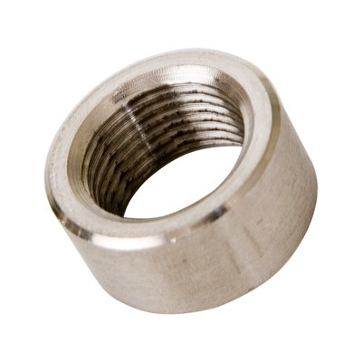

I will ditch the no-name test pipes that i have and buy the fast intensions RHFC along with new downstream sensors, But do you recommend to ask them to add an extra O2 bung with no extension ?

I think you may have a hacked/flashed ECU if it isn't complaining about the missing sensors.
And with regards to the J-bungs, I imagine they would be worse than the 1" spacers that were causing me all kinds of trouble. Have normal bungs welded in for a few bucks at a local exhaust shop.

Any explanation to how the ECU is adding fuel but reducing the injector pulse ?
Just to be sure, You mean a bung like this ?
Is it possible to check with Osiris standard to see if the CELs are disabled ?
Not sure about the reduced pulse, where do you see that? In my case I was having lean codes, but my A/F gauge begged to differ (it was cruizing at 11-12 A/F and wandering all over the place). Not sure about corrections during that time but it might have been going in and out of closed loop.

Yes, that looks like a standard bung. Most exhaust shops have them on-hand.
Take a look at the attached log file ( revving at idle ), You will notice that the injector pulse is reduced while te A/F correction and rpm are increased !!!
You mean that the OEM widebands reading lean, While your aftermarket gauge reading rich ?
The fact that i'm getting high positive fuel trims on both banks that increases with the RPM makes me think it's not a vacuum leak, Sounds more like fuel or maf issue, But i put new pump and swapped maf and injectors with no luck !!!
Could it be due to having many breathing mods with no tune ?, ( headers, test pipes, catback exhaust, CAI, plenum spacer ) .

No, my aftermarket AND oem widebands read rich while the ECU codes thrown were lean codes. I'm fairly positive your issue is the same as mine, it's 100% sensor related.
I thougt for a second that it was a lean condition because of all the mods i have with no tune. But i will take your word for it and install new rear sensors along with fast intentions RHFC since the pipes i have are so raspy.

There's no way any bolt on mods could really require more than 25% + or - fuel corrections needed to throw the code
