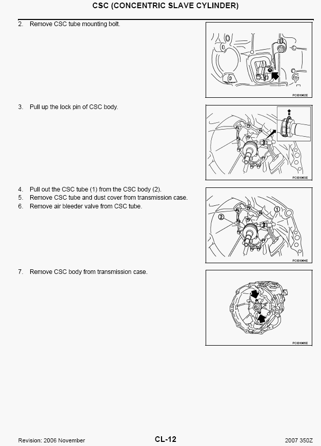

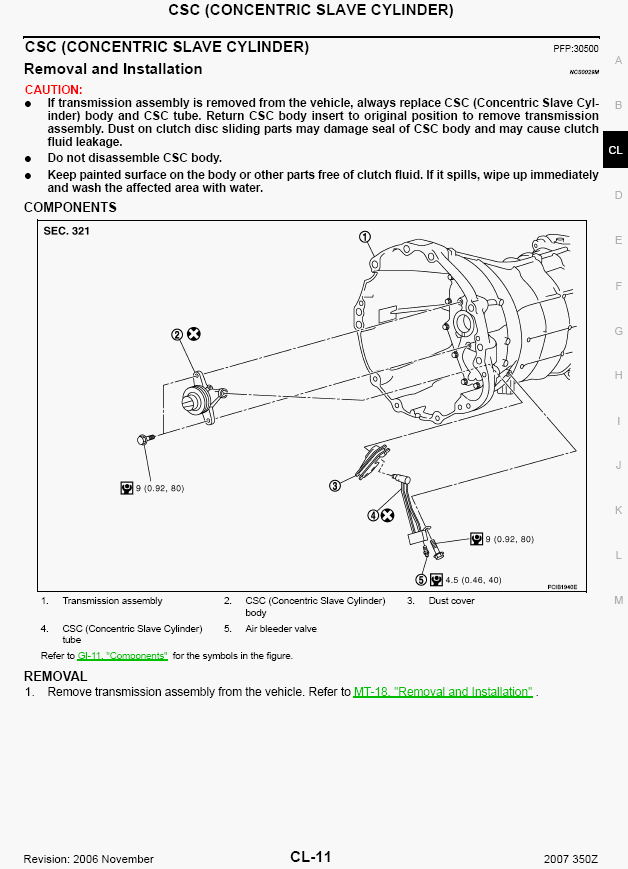

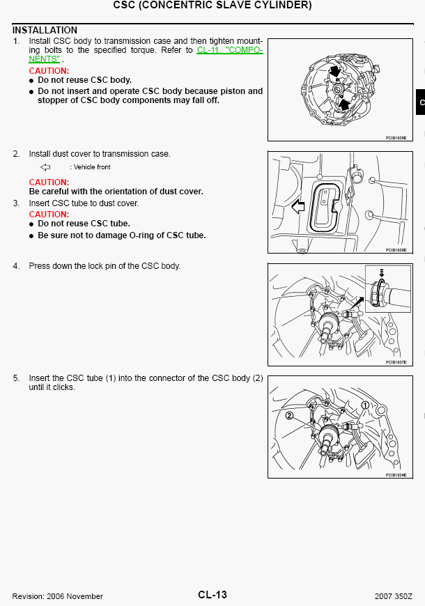

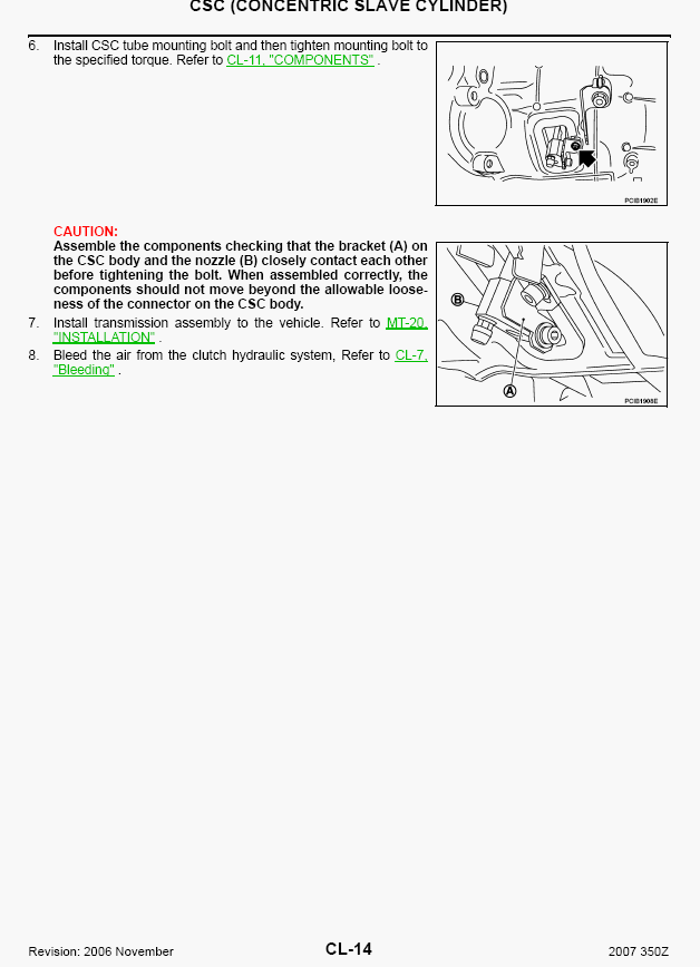

Here is a scan of the FSM to show you where the CSC is at.

damn looks like a lot of work....wonder if the benefits are worth the risk of them f'ing up the install...
