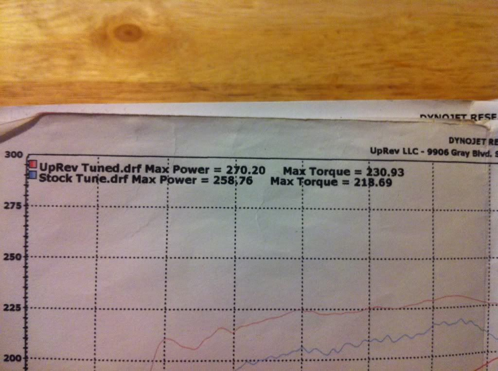

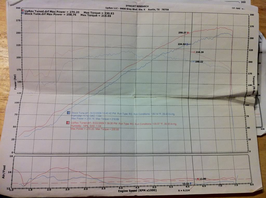

Originally Posted by biggersNISMO
Do you have before and after numbers? (from stock to now)
Wow I can't believe I found them, Dam :0 258whp and 218 Wtq. Memories.
