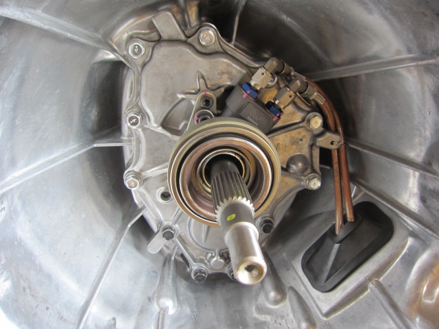

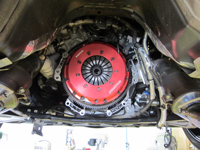

I changed my clutch to OS Giken STR2CD. "Awesome clutch by the way."
I'm probably the last person to post this and not the first, but there are too many unnecessary brackets under the Z.
for every '07-'08 Z or Nismo owner, while changing out the clutch (flywheel and all).You will definitely need the Wilwood Master Cylinder and the Zspeed HD CSC. Not cheap or anything like such, but definitely worth your money.
