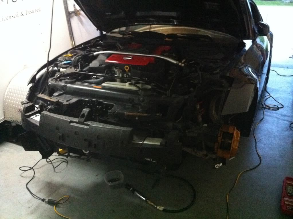

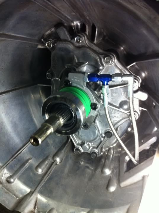

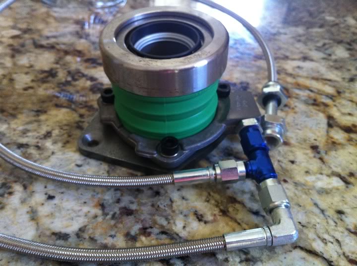

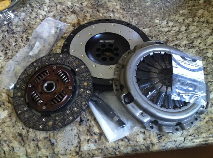

Default consider to change the CSC!
JWT & Flywheel combo imo is the best bang for your $$, it all depends of what do you do with your car.... if it's a DD or Weekend car that you just commute in the city/highway STAY STOCK!! as all you know our OEM CSC (CENTRIC SLAVE CYLINDER) is the biggest piece of crap ever!...once you change to any aftermarket clutch you must change to a Heavy Duty CSC (all metal)..... the stock csc is a time bomb waiting to happen..oem CSC is made out of plastic .if you change your clutch to an aftermarket clutch and neglect the csc and it brakes(about 10k miles) you have to drop your transmission and start again In my case i autocross about 20 or more events per year.. and drive it about 10k miles year..for me is a must..
I HAD 3 350Zs and 2 of them ware HRs 07 touring and 08 Nismo and this problem happened to me and many others...dont let it happen to YOU ! lol
