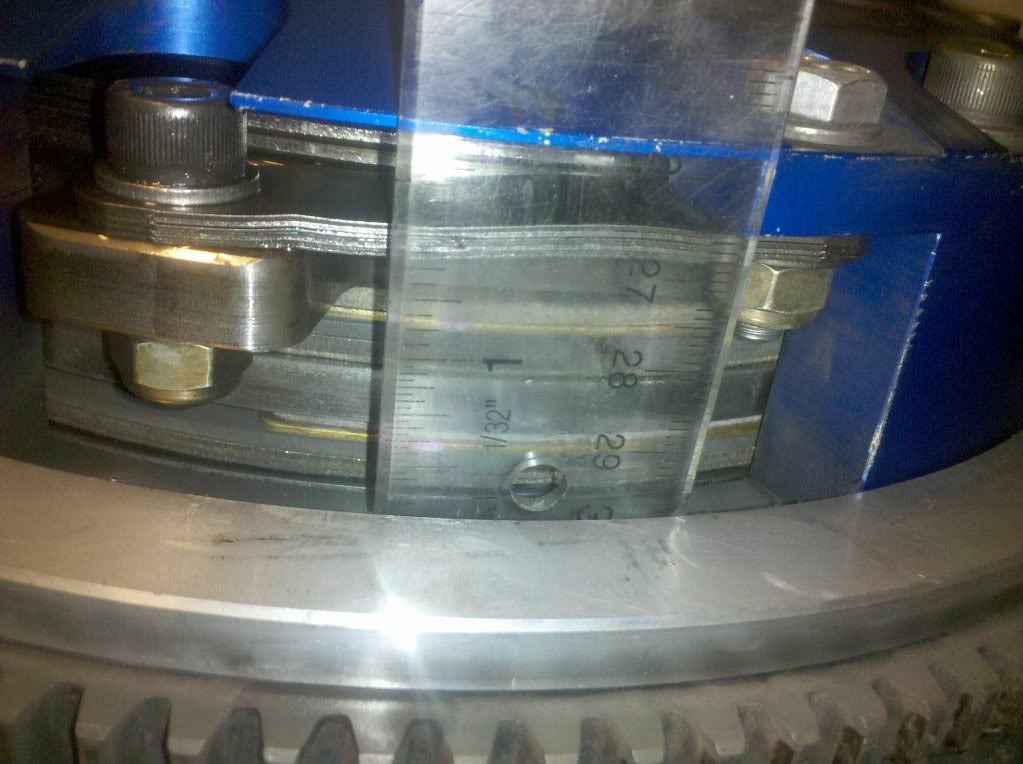

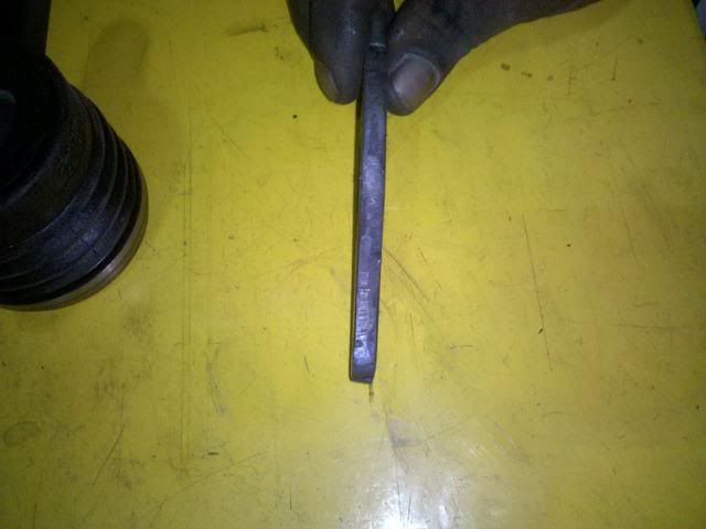

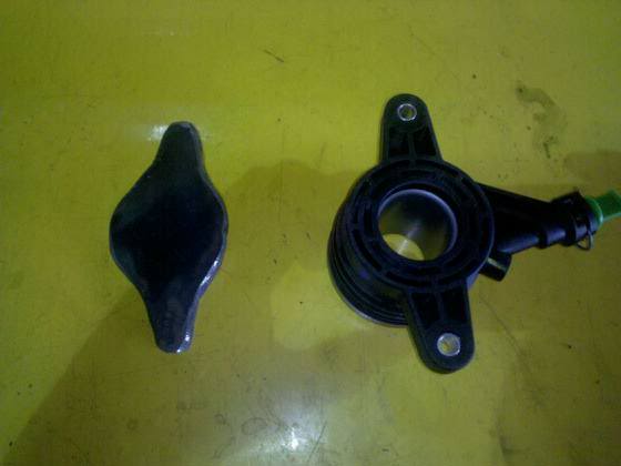

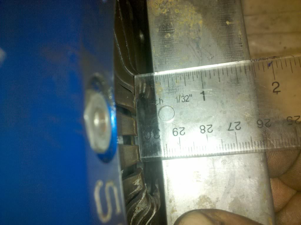

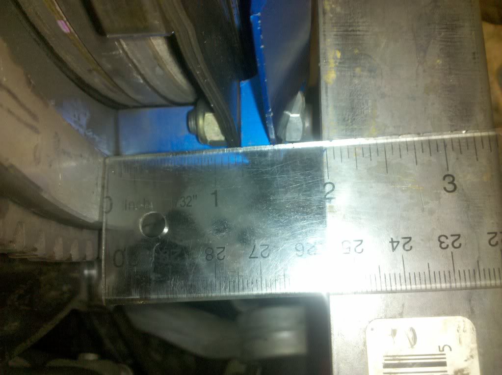

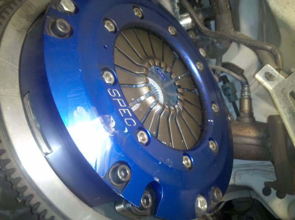

After my slave failed on me for the 4th time within the 5 months that i've had my Spec Twin Clutch installed, I'm convinced that their pressure plate is an 03 - 06 style pressure plate. I called up their tech and they said that their pressure plate is an original design and does not follow the 03 - 06 style pressure plate. I sent them pictures with measurements that they requested. I'm waiting for a reply from them. This is ridiculous. I've spent close to $800.00 on slave cylinders and towing fees.
Here are some pics that I sent them:

Also, my dad tried to solve the problem by creating a spacer. It helped a little bit, but eventually the slave failed again!
You would think after dropping 1100.00 on a clutch/flywheel combo, that the R&D behind the product would be guaranteed. SPEC FTL!

Its really not the clutch. The problem is the slave, They cannot handle the extra load created by the heavier pressure plate and the seal will fail shortly after installing because it gets torn up from the added pressure.
Actually this clutch has the bent fingers to hit the OE slave in the right position.
I have one of my prototype slaves in a car with the spec twin now and are in the testing process to see how it holds up.
