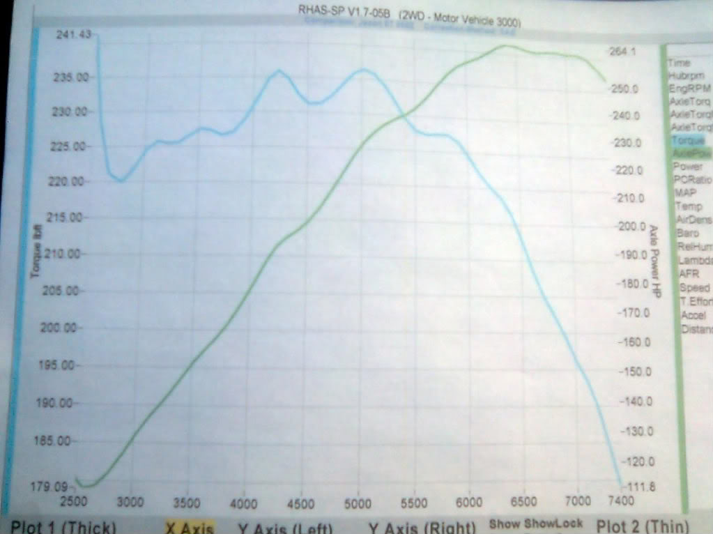

I just dyno'ed my 07 and got the Orisir tune. I have the fujita intake true dual exhaust with X-pipe, stock cats for a month now. We had to stop the base run, the AFR spiked at 22.1 and my plugs are gray. It was leaning out bad. The tuner tried to rich it up and then made a better fuel map. Final dyno is 264hp 229tq. It think thats way to low. What do you guys think? Name:  dyno.jpg

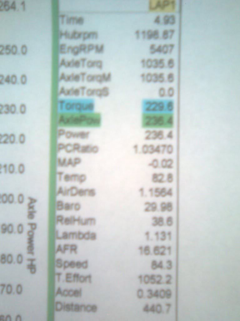

Do you have a sheet with A/F?

No I forgot to get it. I'l have to go and see if its on my dyno file at the shop. I do have this pic, its not the graph but may help. Name:  dynolist.jpg

Get a new dyno tuner. I made that amount in my sig below with just HFCs and drop ins.

Then again depends on the dyno. Dunno what kind of dyno that is, mine was done on a Dynojet.

It was a dynopack. The tuner tried to fix the lean problem. Says thats as good as he could get it with it running super lean. Could the CAI actually lean it out so bad it was dangerous and not be able to correct it? Says he has never seen it that bad

I believe dynopacks read higher than dynojets correct me if I am wrong folks. But that is lowwwww.....
Others here are having no issues getting their cars tuned with more mods than you. My car was running lean with the HFCs and they adjusted it just fine. Your tuner needs to learn how to tune better.
Call UPREV and talk to them about it. Ask Richard or Jared. They will help you as you have their product.

Could someone post a pure stock HR motor dyno run. Because I thought 260's would be close to being stock. Wrong??

I did 261 stock. I now do 274 with just hfcs and drop ins.

I am at work right now so I dont have my graph but I dyno 261hp 221 tq on a mustang dyno stock.

Ok thanks thats what I thought, 260rwhp being near stock. I'm going to the shop where I got exhaust done and putting it on there dynojet to check AF and dyno compair.
