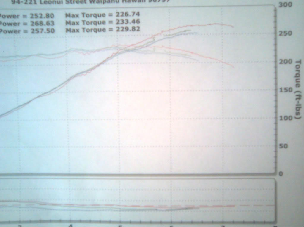

My base #'s with intake and exhaust was 252, after fixing the lean issue and tune it was 264 on a dynopack. Here is new dyno run on dyno jet today. I heat wrapped intake also. This is after uprev tune. Name:  postthisone.jpg

Dynopacks read about 20hp higher than dynojets. Your car is not running like it should. Like I said, CALL UPREV.
How true is this statement?

That doesn't mean Lawrence knew how to tune the car with their software correctly. They are just a tuner that is all.
King, different types of dynos give different results. Mustang Dynos dyno lower than Dynojets, and DynoPacks dyno higher. Do some searching and you will see it has been discussed before.
Not necesarily, it is all up to calibration but your statement is the general idea for dynopacks. If you go to precisionZ's dynopack, which a handfull of members have been too, you will notice your numbers are lower than dynojet readings, about 10-15hp on their dyno i believe. But i'd call UPREV regardless, couldnt' hurt.

My base #'s with intake and exhaust was 252, after fixing the lean issue and tune it was 264 on a dynopack. Here is new dyno run on dyno jet today. I heat wrapped intake also. This is after uprev tune. [IMG]http://i373.photobucket.com/albums/oo179/jace350z/postthisone.jpg[IMG]
that means you gained 12 whp with the tune. its not about the end power, its about the gain. all dyno's read different, so comparing them is more or less pointless

this is not always true. Mustang dynos can read higher than dynojets if you want them to. A dyno is only as accurate as its operator.

Nismo I ended up doing a tune, not the reflash. He didnt feel it was safe to do a big tune because of what the AFR was showing on the dyno. I think im understanding now.
