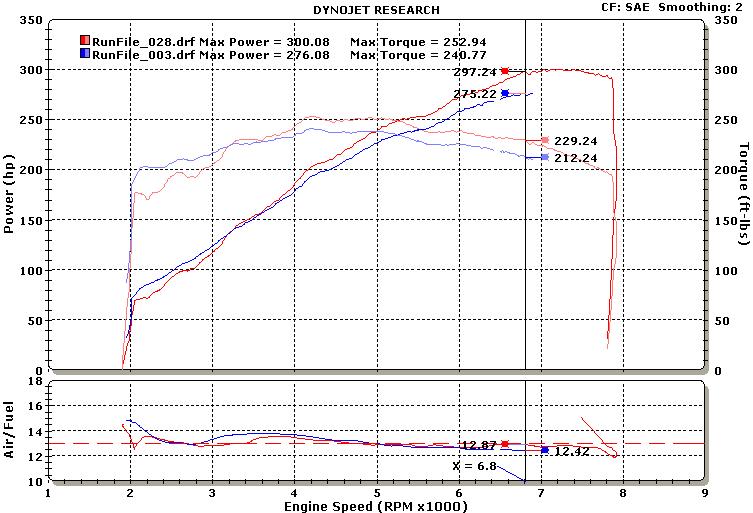

Tomei cams 264 degree intake and exhaust
Tomei headers and test pipes
Injen intakes
HKS High Power exhaust
Head work
Cobb Tuning race software tuning
Just peaked over 300, will have dyno sheets tomorrow!!
Baseline was done with Stillen HFC's, HKS exhaust, Injen intakes and Cobb stage 2+1. Netted 276 whp and 240 tq. All done on Dynojet in 4th gear.
Before and after dyno below. Settled at just above 300 with a safe tune.
http://www.youtube.com/watch?v=IbzU4UIvRvE
Thanks Adam@Z1 and Michael@VividRacing.

Nice bro!!!! Do you think the cams were worth the gain???
Hard to say. Lots of money for only about 30 whp and 15 tq. That wasn't all on the cams alone though. Keep in mind I did the headwork, headers and TP's and custom tuning as well to get that.

How do the cams idle? I'm assuming you are using headers & test pipes for the DE powered cars?
It idles great. Can't hear or feel any lope with those cams. I am using the Tomei headers and test pipes for the DE. Didn't know this was possible until talking to Adam at Z1. Just move one of the bolts on the header manifold into an existing hole.
Originally Posted by stock07g35s
Is this a conservative dyno?
It's a DynoJet, but I guess they all differ, that's why I'm just looking at the increase in power from my baseline ( which included parts that I would guess gave me maybe 15 whp over stock at the most ).

Goes to show it's tough to actually break that 300hp mark in NA form. I like the ~ +15ft/lb of tq. I can't get much more on a conservative tune than 239ft/lbs peak with stillen headers/hfc, bass catback and injen long tubes
