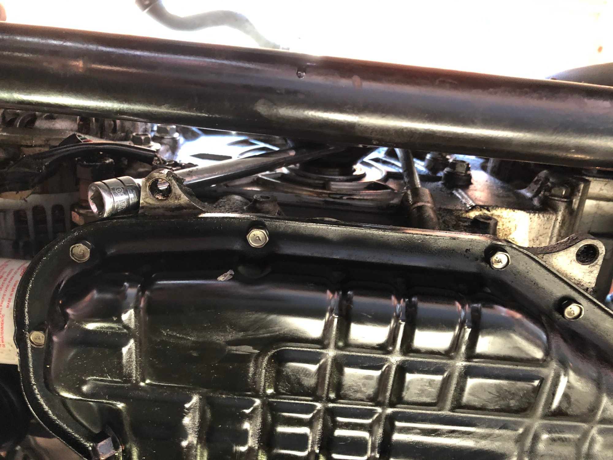

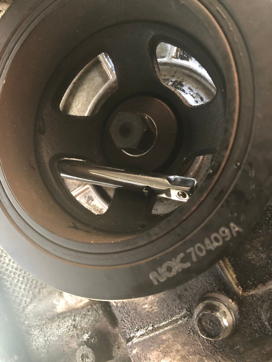

Then I looked to the pulley from the ground and decided to try a regular 3/8 extension bar to lock it:
Here is how it looked:
Lower tip is locked with the engine’s edge
Perfectly locked inside the pulley so I have enough space to put 19mm thick socket on the crank bolt
From underneath
Could be useful for somebody, a <$10 solution instead of spending $40-300 for special tools (it makes sense to buy special tool though, if you’re not DIYer).

Belt method works fine, just didn't with me, my pry bar is not long enough maybe.
The "belt-locked pulley" construction is still flexible, so you need to have more room to actually start applying the pressure... and I don't have straps/ropes for it in my garage.
With the extension inside the pulley - it's instant, locked, no movement or any sort of free play/adjusting.
But thanks for the belt-method, good to have it in mind.
