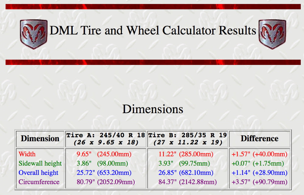

Originally Posted by confusa
Yeah, I read that and used the following calculator which has a handy % difference:
Tire Calculator
So the rear becomes a +1.19% difference. What confused me was if I needed to change the front by roughly that amount to not get into trouble.
Difference in front -rear tire circumference is 4.4 percent. Do not like this with VDC. Try a 30-series tire in rear and run the numbers again.
So stock:
245/40 R18 654 mm 2055 mm
265/35 R19 668 mm 2099 mm
Difference % 2.14
But 275 35 19 rear and stock front is:
275/35 R19 676 mm 2124 mm
Difference 3.36 %
Looks like it is awfully close to the percentage where problems would arise if you don't bump up the front.

I run 245/40 and 275/35 and I have no issues. Running 255 up front closes the gap even more. I believe it is more of an issue for VDC if your front is bigger than rear...

I'm running 285/35 rear and 245/40 fronts on Rays Nismos with no issue with VDC whatsoever, car does tend to understeer but that will change once the shtty S Drives in the fronts wear out.
