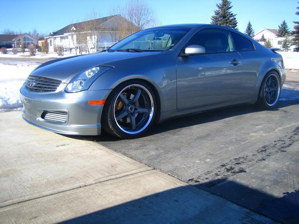

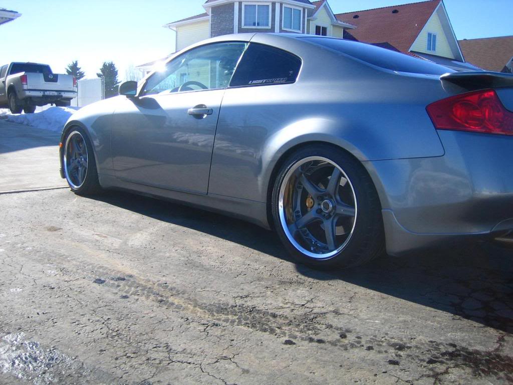

GTS come in 19x9.5 +17 and 19x10.5 +18 those are the offsets you want +30 will look sunk and need a 10mm spacer to look anywhere close to flush.
Here are my old GTS with the above specs, the +30 will be sunk 13mm and 12mm more respectively
