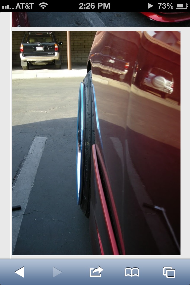

I am currently on stock rims on my 350z with 245/40/18 F and 275/35/18 R. I'm receiving my Varrstoen ES2 18x9.5/10.5 +12/+0 offset. Also I'm getting the Eibach Sportlines lowering springs. I want to be stanced like the picture below but have a stretched tire with not too much lip like the following picture. Question is would I be fine switching my 245/40/18 tires from the front to the back and buying say like 215/225 size tires in the front? Remember I'm going to be dropped with the Eibach Sportlines.. I need serious help for the way I want to sit.

A LITTLE bit less lip than that is what I want.
Mount your current tires on the new wheels. It may work out well for your wants.
