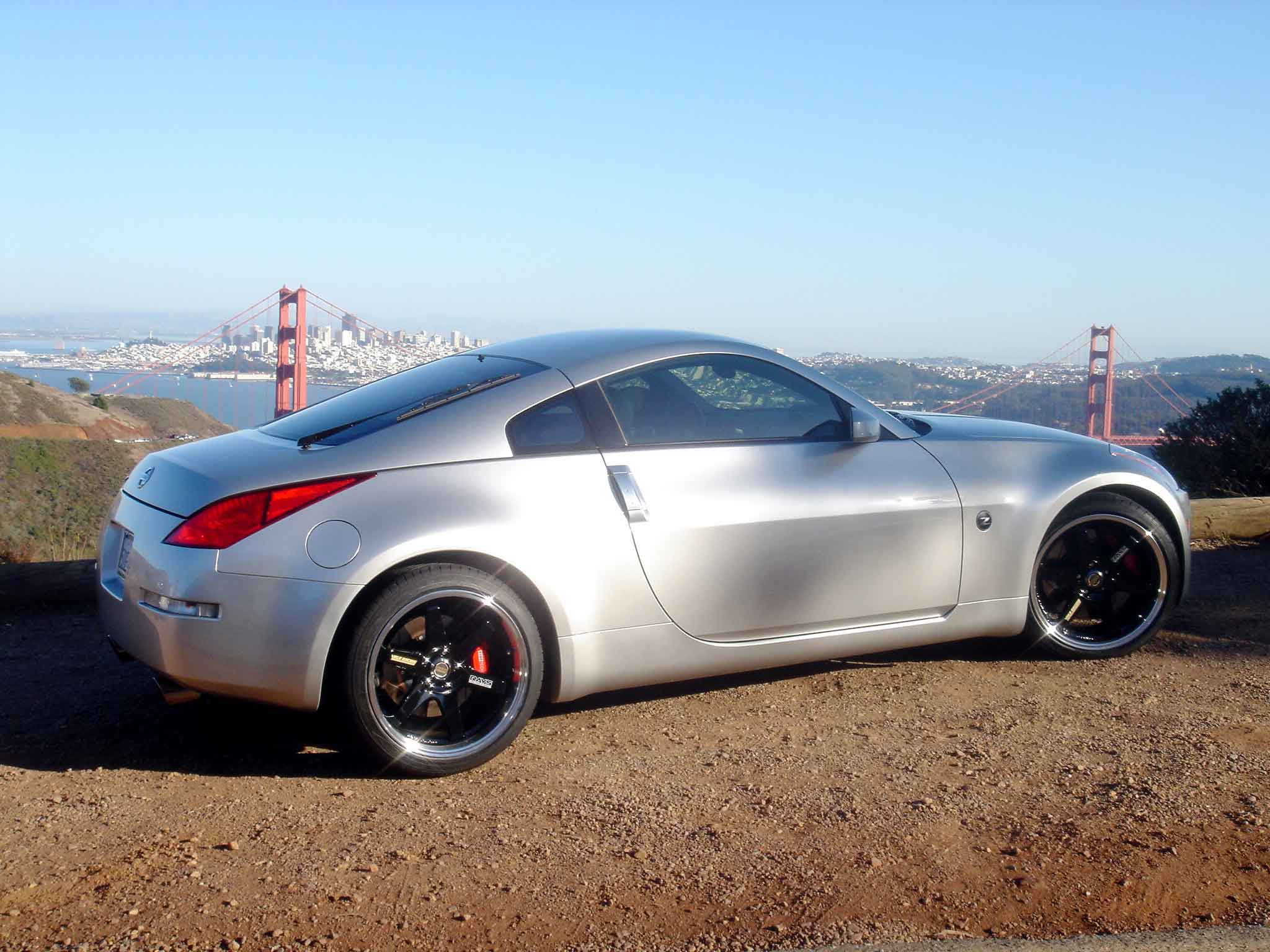

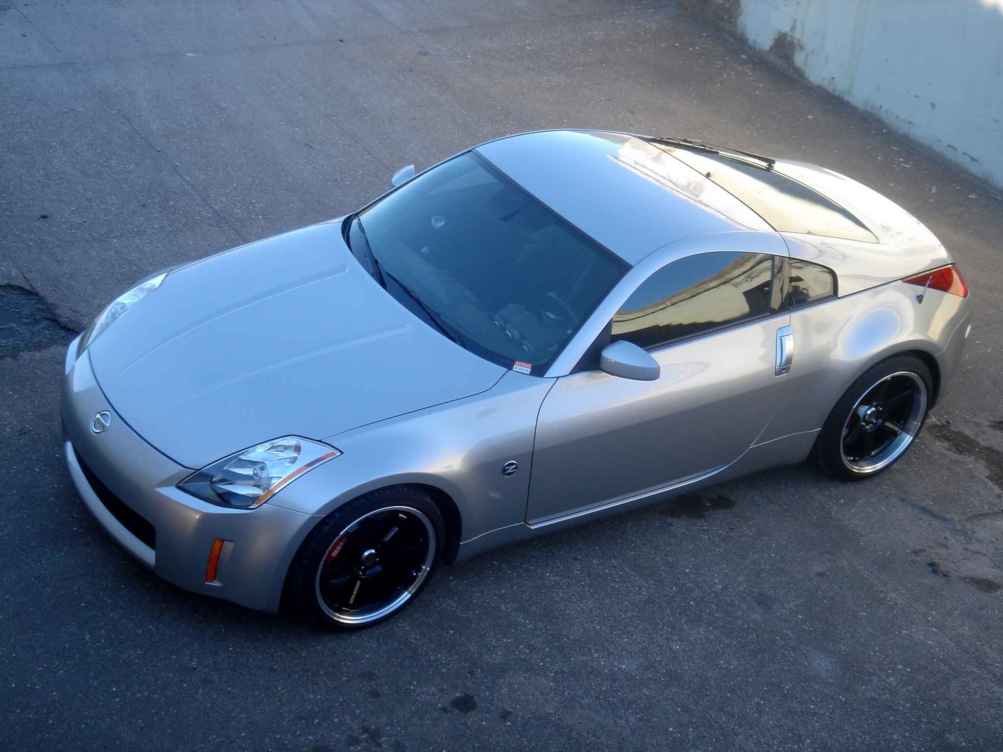

So I had 19" Axis Hiro's 8.5 front/ 9.5 rear. I had 245/35/19 front - 275/35/19 rear. I decided to upgrade to the LE37T 9.5 front/ 10.5 rear w/ +22 offset.
I still had some tread left on my tires so had them put on these wheels so they're a little stretched. The new Volks, being an inch wider are sticking out pretty far and I'm worried that when I get 275's on front and 285's on rear that I'll have some rubbing issues. The Volk guy says if I drop my car it will be fine. Does anyone have a simular setup w/ drop? Or do I just have the wrong offset?

Looks good. I doubt you can go 275 on the front...

I have those wheels dropped about 1.5", 255/35 front 285/35 rear. I had to roll the rear fenders because it rubbed pretty bad. The front is fine on smooth roads, when going up inclines turning I also rub slightly. Im not sure if you can run a 275 front with the +22 offset, most Id go on this set up is a 265. You will need to roll or cut your rear fenders with a 285 out back. Click the link in my signature to see pics of my set-up.

Alberto, thanks for the reply. Your Z looks great. You think If I only drop 1" that might take care of the rubbing?

no even on just tein s tech (less then 1 inch drop) a 275 up front will rub badly. im also pretty sure that with the 275 and 285 combo your cars tcs and vdc just might go wack on ya. thats a rather interesting combo and definately in excess imo unless your runnin a tt stroked z. i think 245 275 or 55 and 85 is plenty of rubber on teh ground to keep traction especially on what appears to be an n/a z. just my opinion but i dont even think 275 will fit up front with those offsets unless your widebody.

ZinFla, thanks for your reply. Good advice. I probably will go 255 up front. Actually the 245 up front isn't stretched too bad. Your right, it's a bit over kill for a n/a z but going tt stroked may be in the near future.

I have the same size with Toyo T1-R 255/35 & 285/35 tires with the rear fender roll and it rub when i go over bump.. but I got my rear camber corrrected to better spec...

Thanks, I still think you will rub. I only paid $80 to have rear fenders rolled so its cheap piece of mind. I would def suggest the 255/285 combo on the 9.5/10.5" wheels, they look and handle great. Front is very slightly stetched (with KDWII's every tire is different) and the rear looks perfect.
