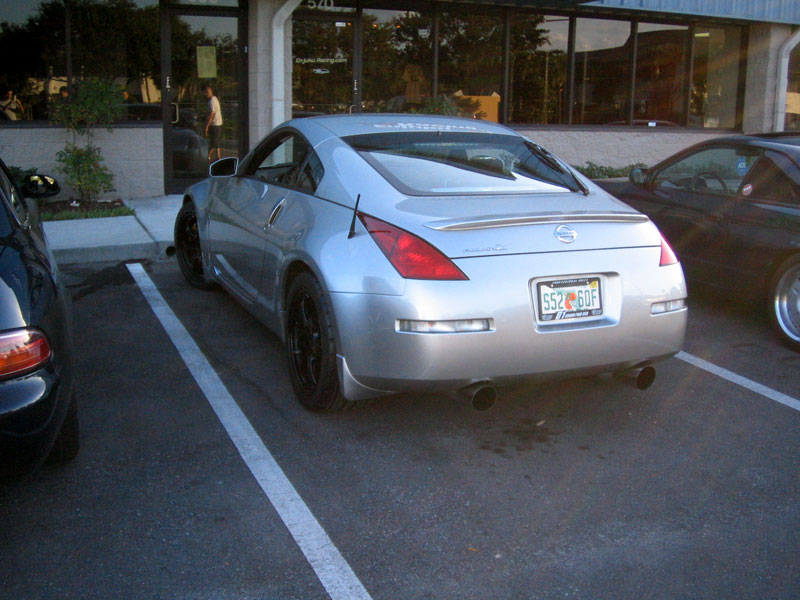

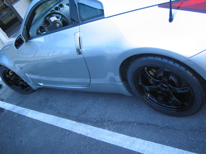

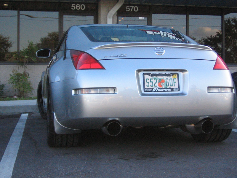

It only cost $175 each. Find me a better wheel for that price. Here are the pics. I am getting them painted glossy black right now. When I get them back, I will post more pics.

the pictures do help illustrate what you have
i will add a couple more problems now
#5 - you added 2 inches on the inboard side of your hub. the track rims are +33 offset in the rear to start with (ie. tucked in). i hope you did your measuring, because you are going to be awfully close if not on top of your struts with +33offset +2inches +295 tire.
#6 - i don't know since i've never done that to a wheel, but how strong is that?
pp

I did measure. I have a 15mm spacer for the rear. If the wheels have 0 camber they will be flush. 1.5" or 25mm will be too much. I would have to camber the f out of it to clear. I did put the wheel on without the tire. It had plenty of clearence. it should be fine.
As far as how strong will they be. Supra and Mustang guys do this all of the time. I had them done bt this company: http://www.weldcraftwheels.com only time will tell.

Here are some pics I took while he was at our shop today. I like it!
