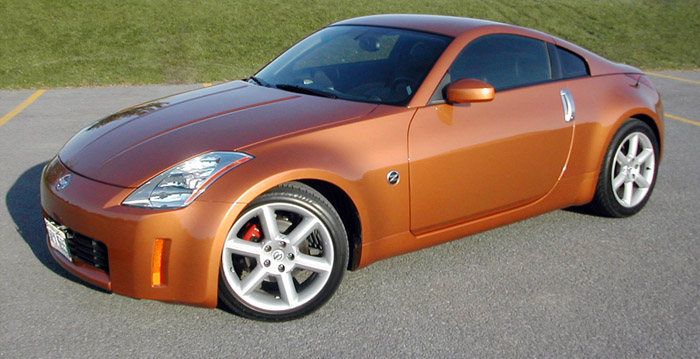

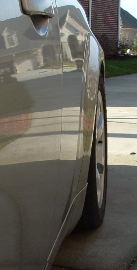

I have stock 18' and stock suspension/shocks and I have a H&R hubcentric 25mm spacer in the back and have no rubbing. If you think about it, people are able to put 275 flush to the body and have no rubbing. It's only when you get to the 285 wheels that you need to worry about your offsets.
As for lugs not being long enough, the H&R spacer cames with longer lugs on them.
As for strain and such, when you think about how a wheel goes on a car, you will see that putting a spacer on won't strain it. And are you really gonna go offroad ralling to be concerned about straining?
See how you don't have to worry about long lugs:
And here is my car with the 25mm spacer on the back. notice how the wheel is flushed to the body. Makes your car look more agressive. One of my favorite and affordable mods.

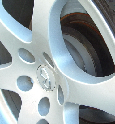

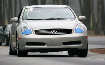

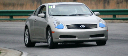

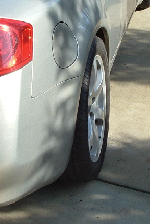

i also have the 25mm h&r spacers on my G35 coupe. Much better look, noy all tucked in.
try ebay.. they're always on sale there.
