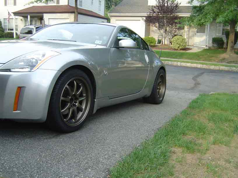

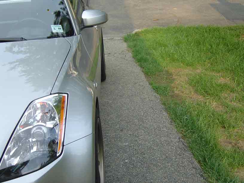

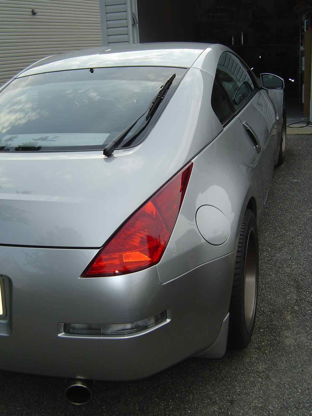

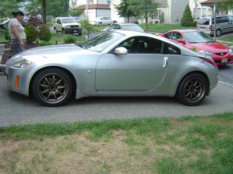

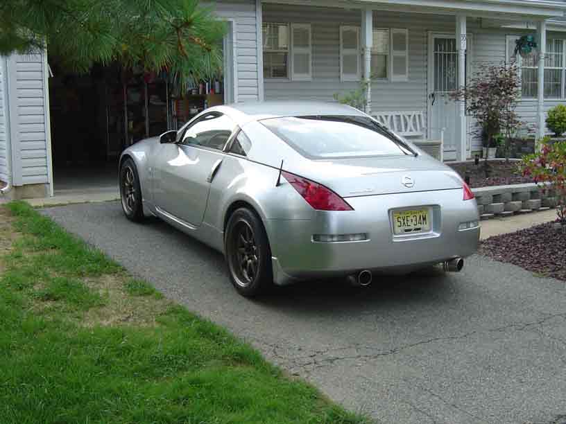

Work Emotion XD9
245/40/18F
275/40/18R
18X9 +18 F
18X10 +20 R
Stock height, no rubbing issues. Front is slightly tucked, but looks perfect. Rear is perfectly flush. Needs to be lowered otherwise it looks weird.
No problems w/ TCS. Tire sizes are recommended for 18s by Nismo, so no VDC problems either.
