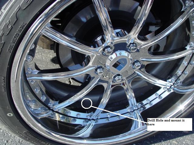

I just had my stock TPS sensors installed in my new 20 inch Asanti's. I just had them drill another hole to mount them in and they work beautifully. No lights or beeps, and they read the right tire pressure. You can have them drill a hole in the inside of the wheel behind a spoke, you wont even see them. Piece of cake.
Ha, you've got some *****. I would never drill into my rims 1. they lose their value and 2. what if they f up, then you going to wait another 3 months to get another wheel from volk. There HAS to be another way around this, and i know alot of people use the TPS in aftermarket wheels on here.
^ Agreed. Doesn't sound like the best idea. If the hole is at all incorrectly drilled, you could end up with a constant air leak. Plus, what do you do if you ever want to sell them??
It works out well when you have a top notch, high end wheel shop take care of this for you. And if they F it up, they buy you a new one and have it expedited from the manufacturer, no sweat off your sack. There is another way around it, strap it to the inside of the wheel with a wheel band strap. Just hope it doesnt come off and start bouncing around inside your wheel.
If you end up wanting to sell them, you just pull them out and replace them with rubber valve stems, simple.

Call me crazy, but when you have a 2500 dollar tire pressure monitoring system built in stock to your brand new Z, it would be nice to use it. Just my opinion and reasoning behind keeping my TPS system working, but you guys can take it for a grain of salt.
Yes, I am crazy, but atleast I know when I need air. LOL
