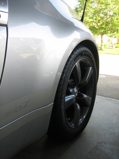

275/40/18 rear will fit fine....the fronts will be tight if they even fit.
