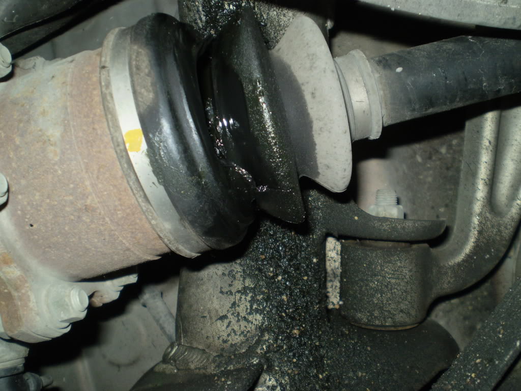

Originally Posted by Max-G
[IMG]http://i31.photobucket.com/albums/c400/mexfoodisgood
Hmmm Looks Familiar
I agree, it's worth it!

Call me what you want but what is that and does this happen to all slammed Z's.. if so I need to check mine.

^^^ it all depends on your driving.. I believe max drifts or races. I hand no problem with mine what so ever.. Just watch for pot holes or huge dips.

it's the cv boot. i've heard of it happening on several lowered z's. it's kind of inevitable if your car is slammed due to the increased angle of the axel. that happened after driving 9000 miles with my coils as low as they can go and a couple of drift events.

Is there a fix for this? Besides replacing it with another OEM boot? Any aftermarket CV's that can handle the track?

^^ yup yup.. I'm buying these for my build
http://www.driveshaftshop.com/import...-level-2-axles
