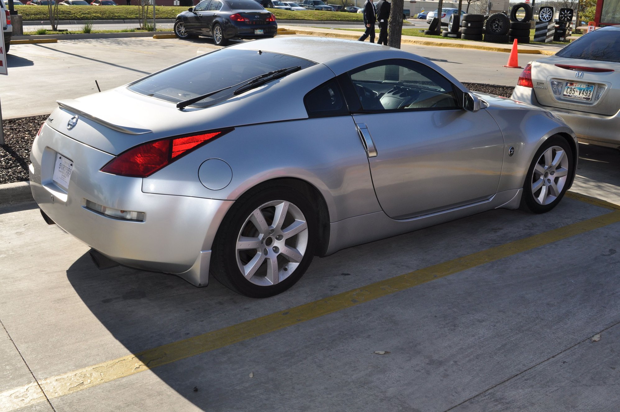

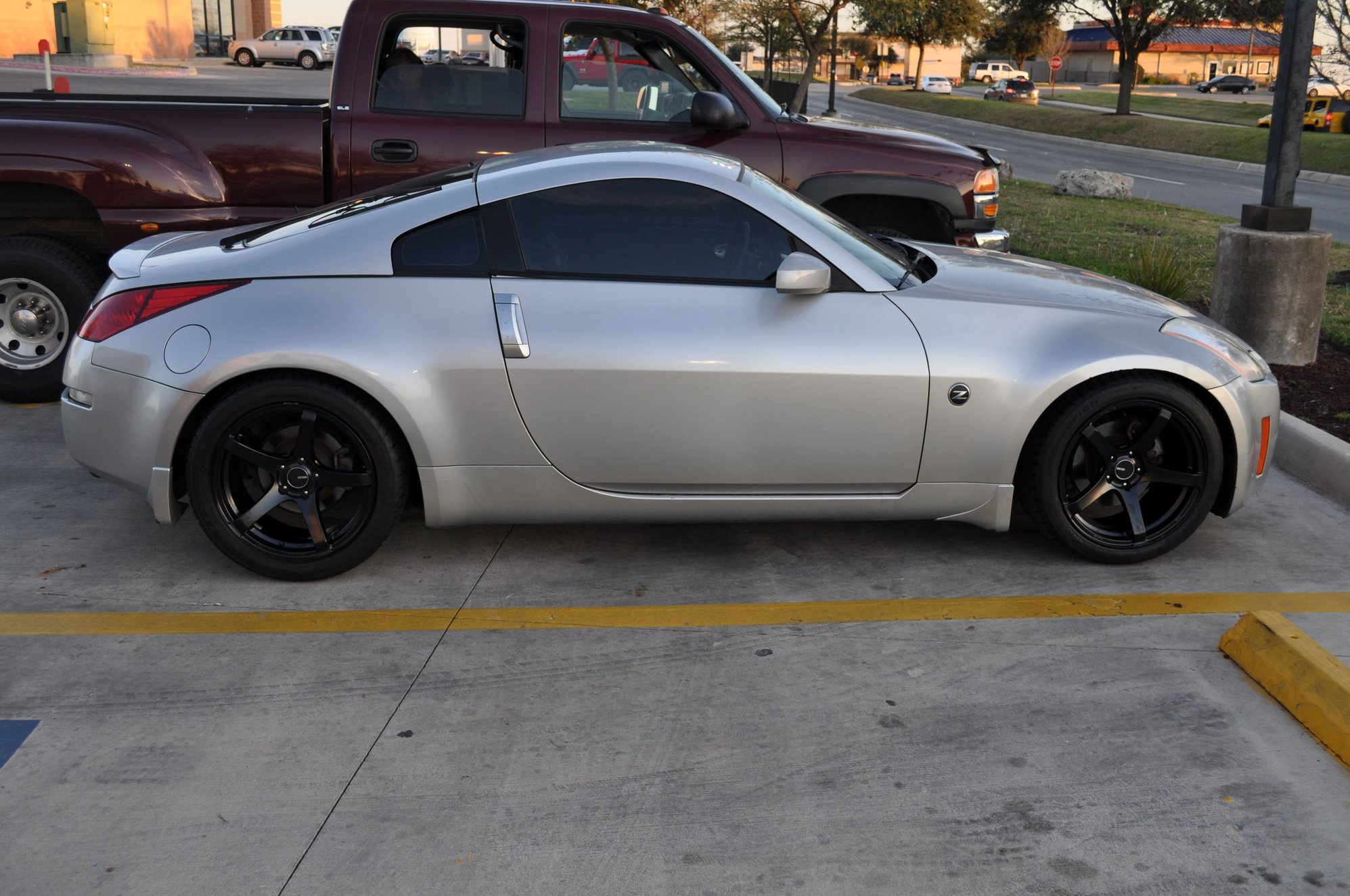

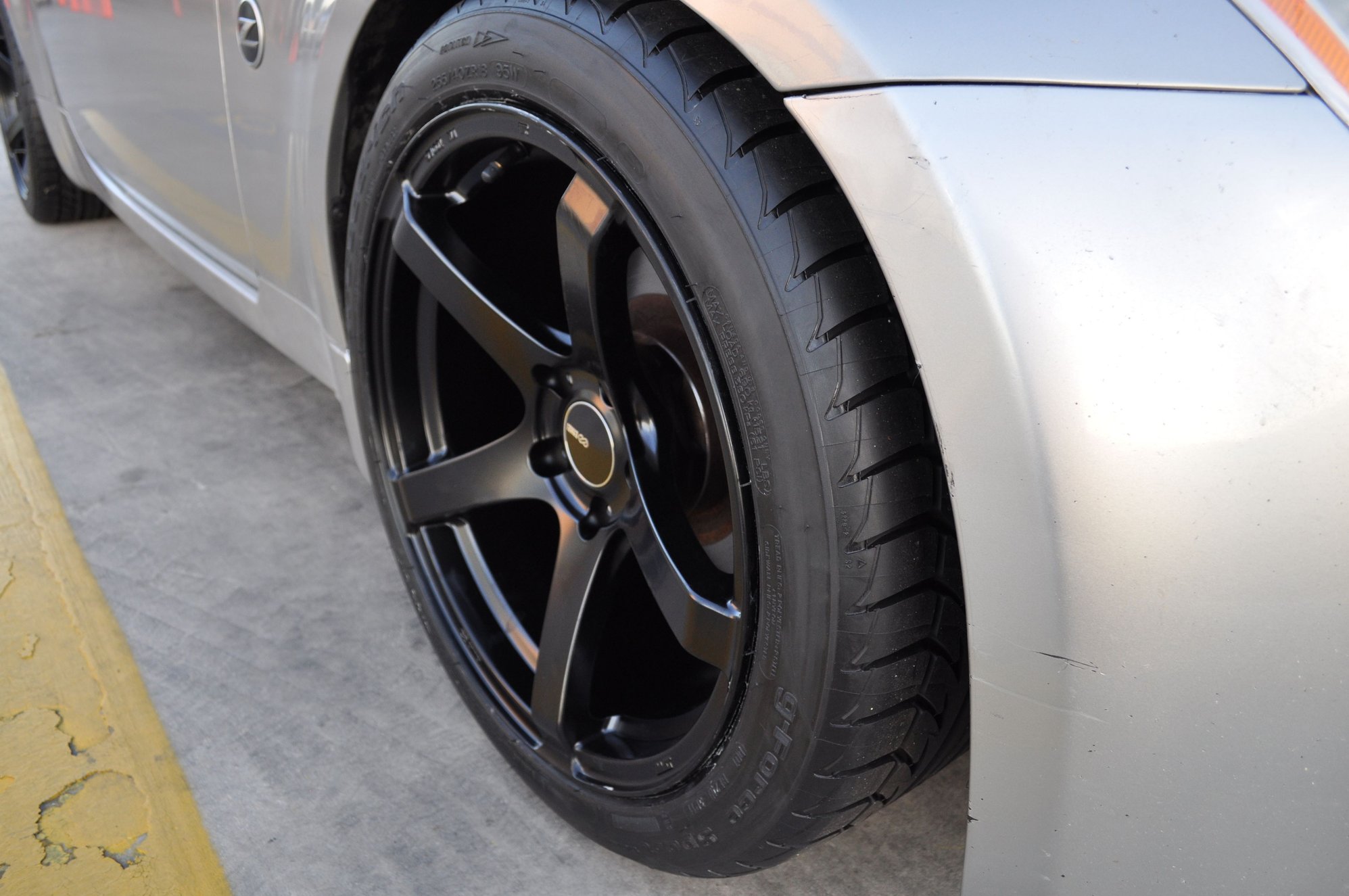

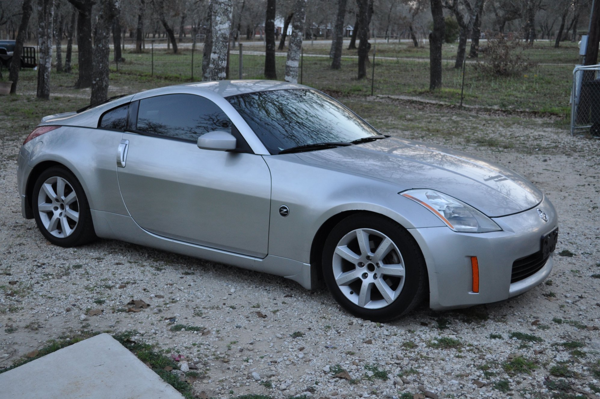

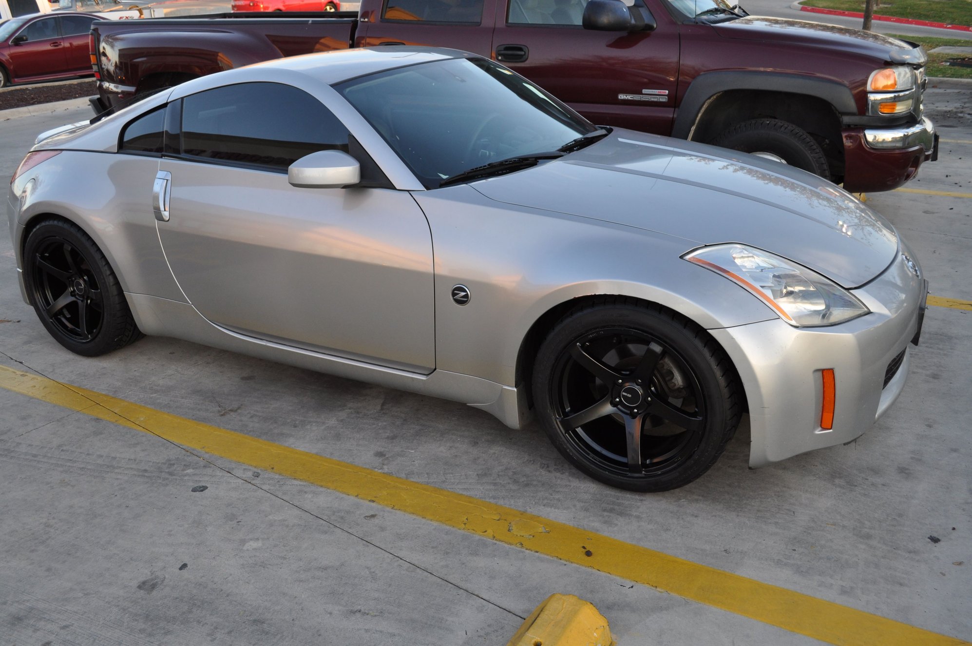

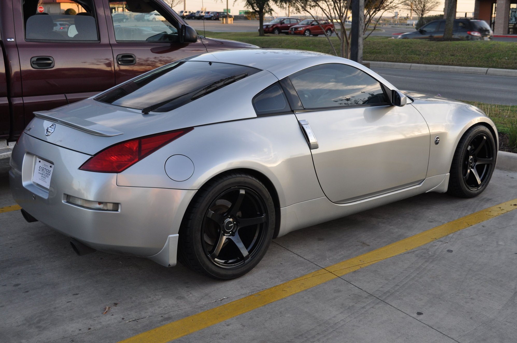

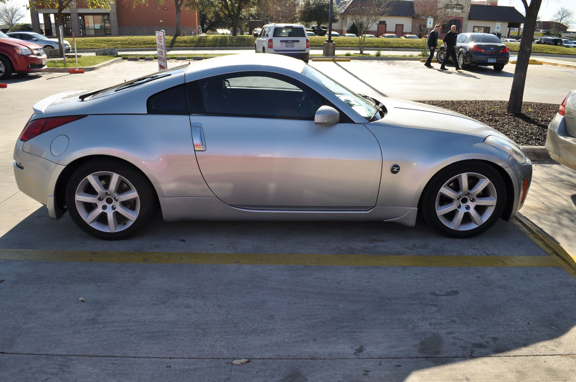

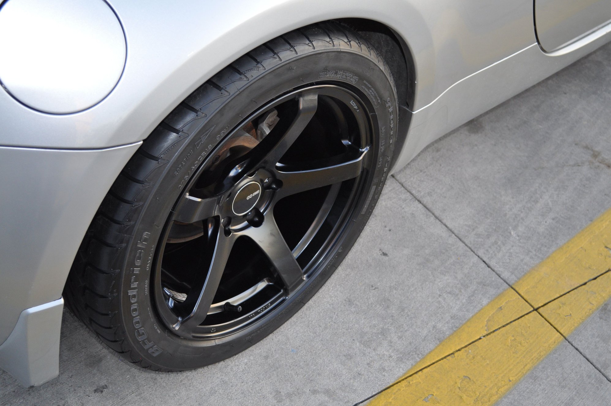

Got my rims! They are 18x9.5 with +15mm offset. Here's some before and afters.
That is my Duramax in the background. It got new Michelin Defender LTX M/S all around. Today was an expensive day, lol.
They are very flush. No spacers. 275/40 on rear, and 255/40 on front.
The rims and tires, lugs, mounting and balancing and all that stuff came out to just under $2300.00. Not bad for some much needed traction, and a way more aggressive look. The old tires and rims looked like they belonged on a Prius or something.
