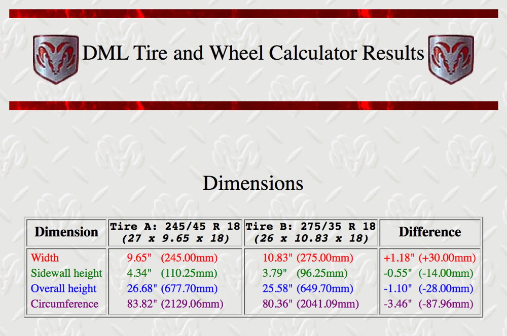

Originally Posted by starbuck
The offset is +15. I'm on S-Techs. So 265/35F and 275/35R should be good?
You have decreased rear axle ground clearance by 14 mm.
Actual speed 100.0 MPH. Speedometer will read 104.31 MPH.
Is this good for you?

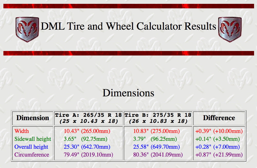

Difference in tire circumference is 1.08 percent. You drive a Performance to VDC? Read and study: https://my350z.com/forum/wheels-and-...read-here.html

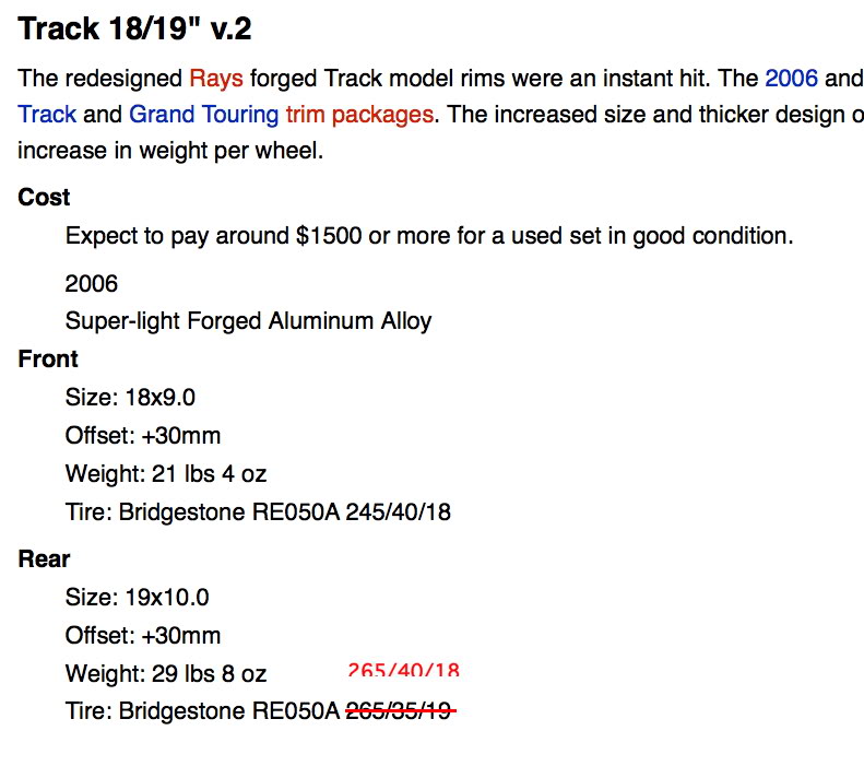

Dude you're probably way smarter than me, that's why I'm asking lol. What's a good size to put on my vehicle with my current setup?
You are in luck because Nissan has figured out all this stuff for you. Instead of a 19 inch wheel you have a 18 inch wheel. Increase the series by 5.
