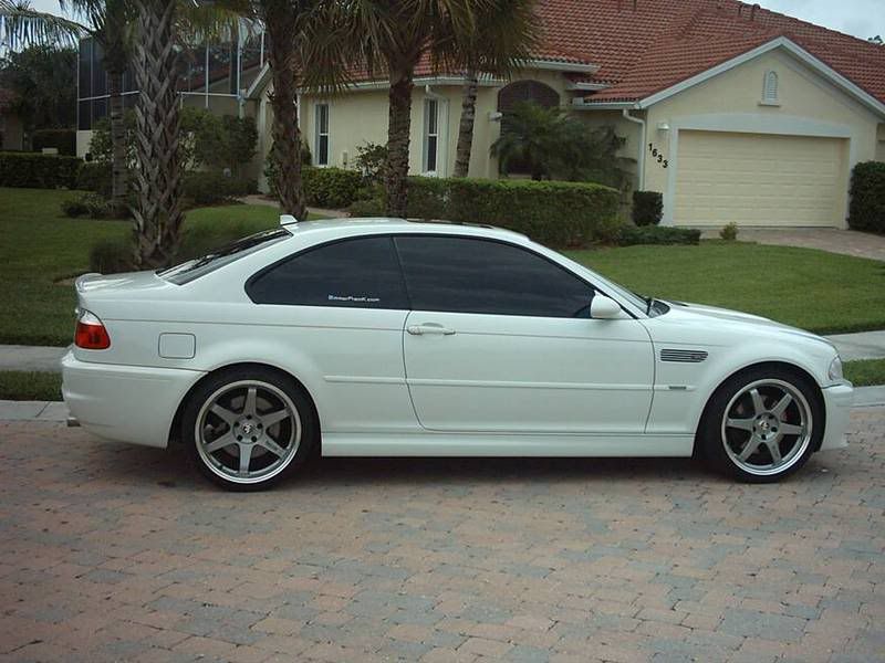

Originally Posted by j-velocity
Off set is different..
And please don't put Volks on any cars other than Jap...
Hmmm....
Looks pretty good to me w/ Volk Wheels
