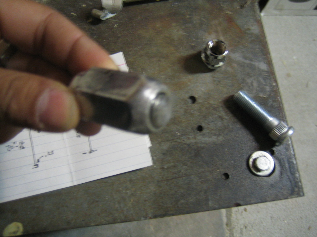

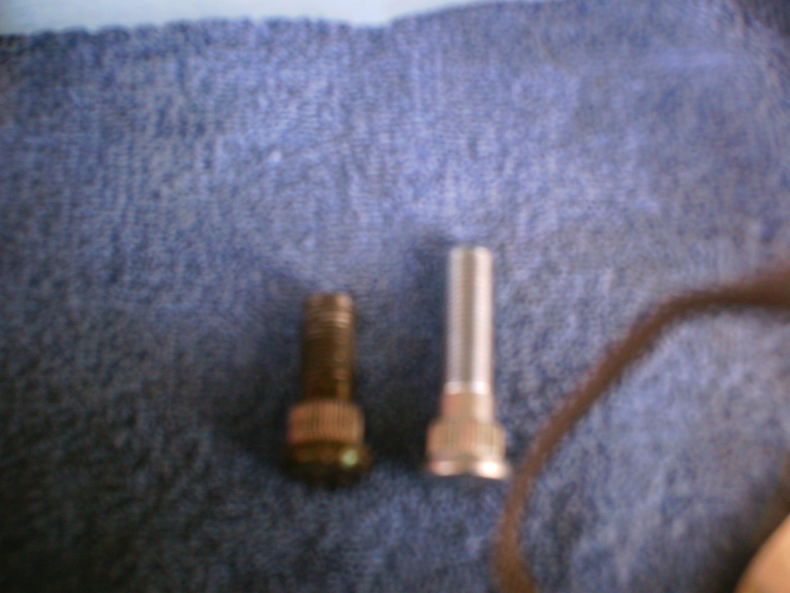

Default Pics
Here Are Pics Of The Broken Stud Still In The Oem Lug Nut And The Napa Replacement Stud Listed Above.
- J

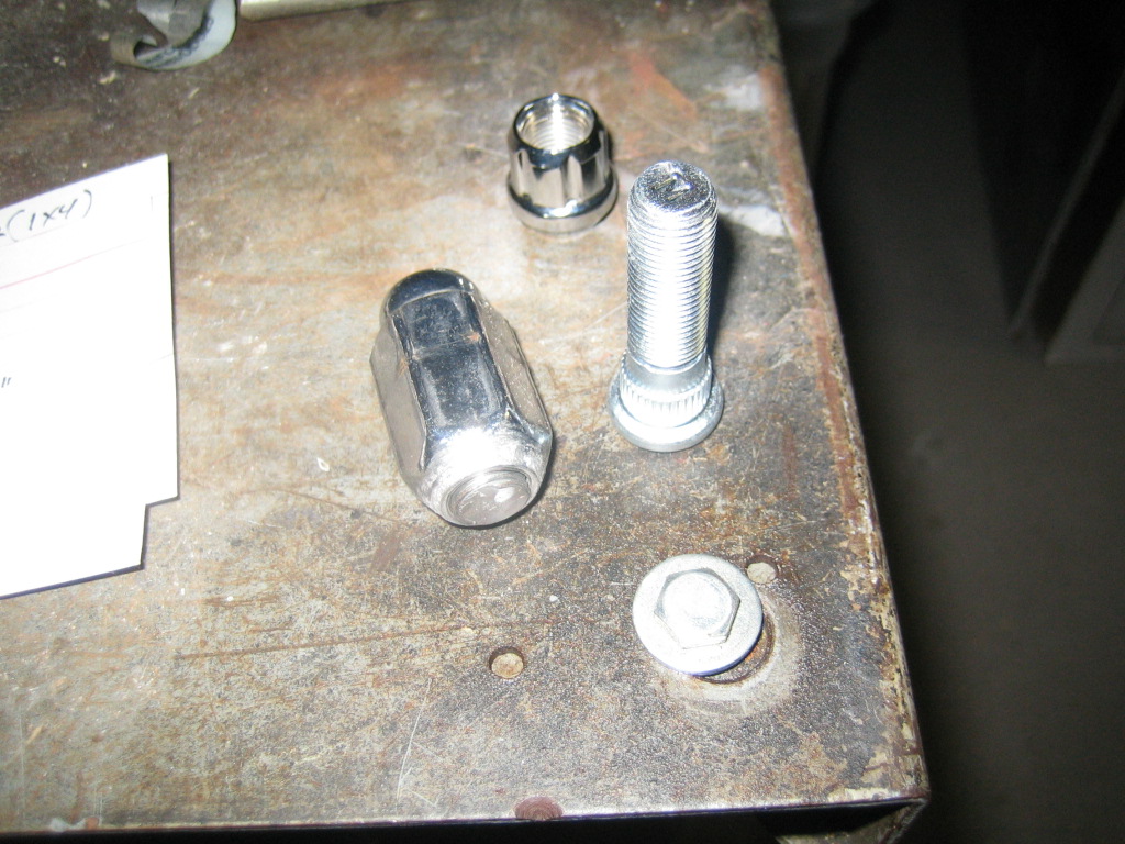

Default HF press and Alternate options:
More Pics. Harbor frieght: (ITEM 4711-7VGA - about $80 bucks)
Alternate option #1:
With the pic shown, you are still essentially pressing the stud in from the head side..........see that? so essentially its like using a press.....of course this is quite hard, you need a vise to hold in place and obviously a large socket that fits inside the stud with out the stud bottoming out on the c clamp as it tightens up..
Alternate option #2:
Use a Vice only instead of a C clamp like Alternate option #1 - but its all about lining up well...
Alternate option #3:
Kinda like method 3 i talk about on post #10
which is STEP 11 of the thread:
https://my350z.com/forum/body-interi...e-of-pics.html
I must also like to add - this was brought up in the "official wheel spacer thread"
You can get away with out using a "press" if you do the "6 ~ each washer/pull through" method.
Thats not the proper and intended way to do the job.....ie - pressing in from the head side with a press is the "correct" way....
The way you can also do it -- "WASHER/PULL THROUGH" method, you are pulling the stud through the spacer using a few Washers from home depot/lowes, etc and with a sacrificial nut, you simply tighten the nut pulling the stud through......
HOWEVER:
This method is putting a lot of stress on the stud "threads".......you could pull/damage the threads when tightening it up that much....sometimes its just one thread thats cracks at the thread valley groove, and you don't know it till the next time you do a wheel change and you find that that "Replaced" stud gets cross threaded or something..
HOWEVER/also....when replacing a stud using the "WASHER/PULL THROUGH" method in a SPACER you can get lucky doing it that way since the spacer itself is softer ALUMINUM and the splines from the stud neck most likely line up or match from the previous stud lines/neck that was originally in the spacer........
So if i was to do the washers/pull through method i would do it on a spacer if i had to over a hub anyday......so you may be fine... just be mindful of which studs you replaced as time goes on......and keep an eye on it...
-J

just a question, but how did you break the studs? over torqued them?
Old Mar 18, 2008 | 11:19 AM
JasonZ-YA's Avatar
JasonZ-YA
iTrader: (60)
Posts: 11,204
Likes: 32
i believe so, it was the tire shop that changed my tires out for me... they used the air impact to install them.
a bit later i go to take them off and the lug nuts free up then after a few turns they get tight again???? i kept going with it and got a few really hard turns out of it and then snap!
- Jason
