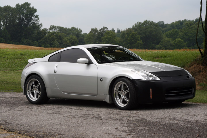

I got mine for around $1500 for new wheels, new tires and new spacers. I got AZA wheels 18/8.5 front and 18/9.5 rear, Tires are Sumitomo HTR Z III 255/40/18 front and 275/40/18 rear. The offset for the wheels was +35 so I also got 2 sets of 20mm KICS spacers. The offsets are now +15 front and rear. I think it looks good for the price (we all cant be rich) and the car grives great!! My wheels look just like SSR GT3 wheels, but cost alot less http://www.tirerack.com/wheels/Wheel...All&sort=Brand
