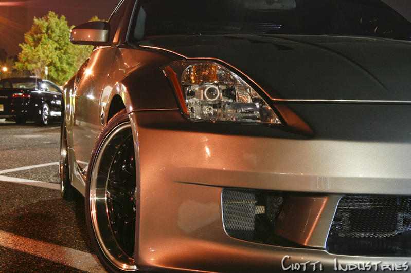

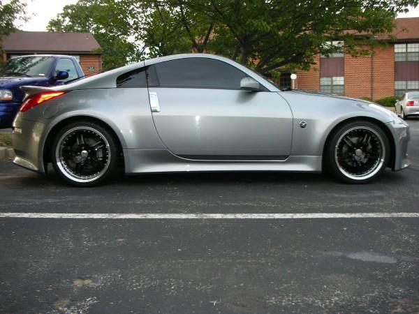

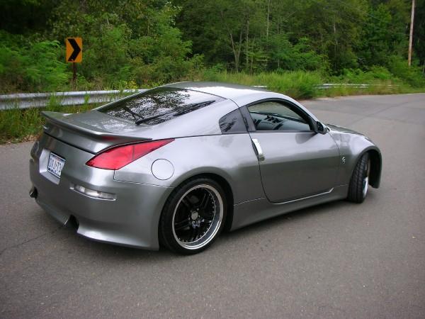

So i know its to late, But i have 19'' Rims, They sent me 35 series tires to go with the rims, is that right? They look a bit to low profile and i hate the extra wheel gap? I dont have to many miles on them, but am thinking of buying new ones? Please help!

Thanks guys for the help i have 8.5 in front 9.5 in rear, and im running teh same type of tires as yall say. so i guess im good. Just looks funny (check out the pics) But thank you so much for the help

looking at your pictures, the problem may be your offsets.

Thanks again, he offset is +35mm front and rear, But your absolutly right i need to lower it!!!
