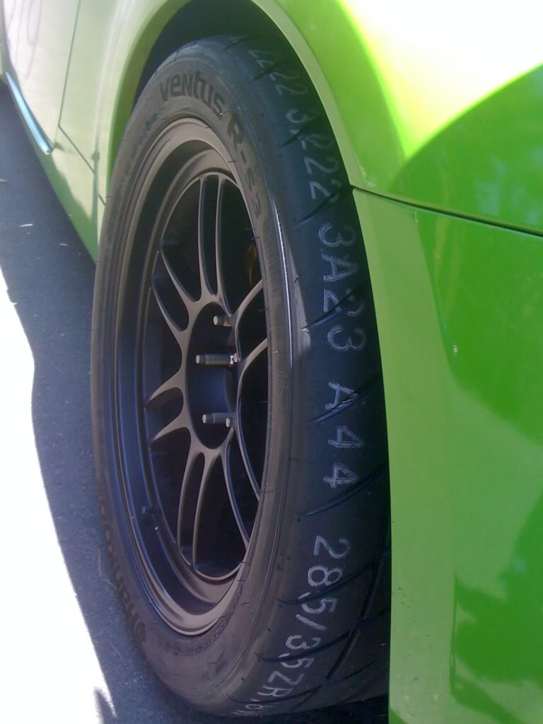

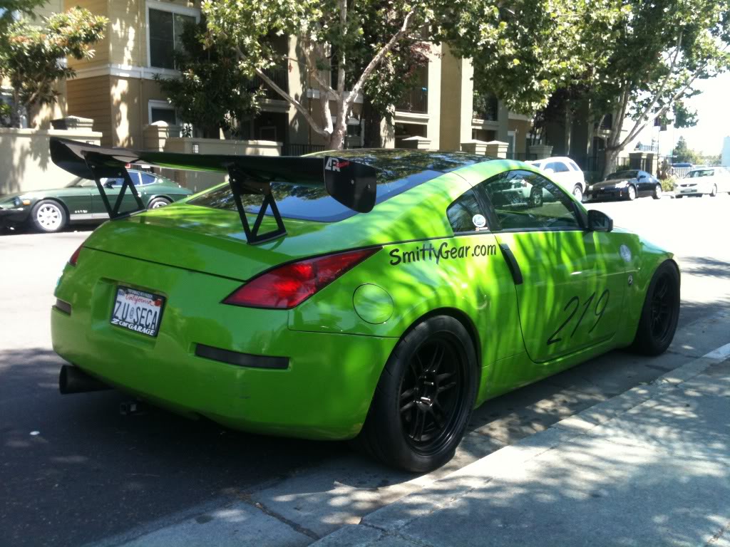

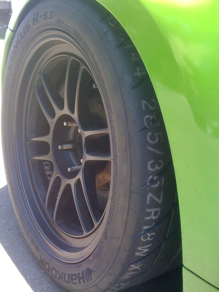

This was with 275/40/18 front and 295/35/18 rear. I'm curious if I can fit 285/35/18 front and 305/35/18 rear.

YOu can, but i would want a 10.5 up from for a 285
According to Hankook, a 285/35/18 R-S3 will fit a 9.5" wheel just fine.

Thanks terramask, but I already own my wheels. I was asking if a 285 will fit my 9.5" fronts without rubbing...not if I should replace my wheels.
I have run 285 RS3s on the front with a few set-ups. What's the offset of your 9.5?
They're +15

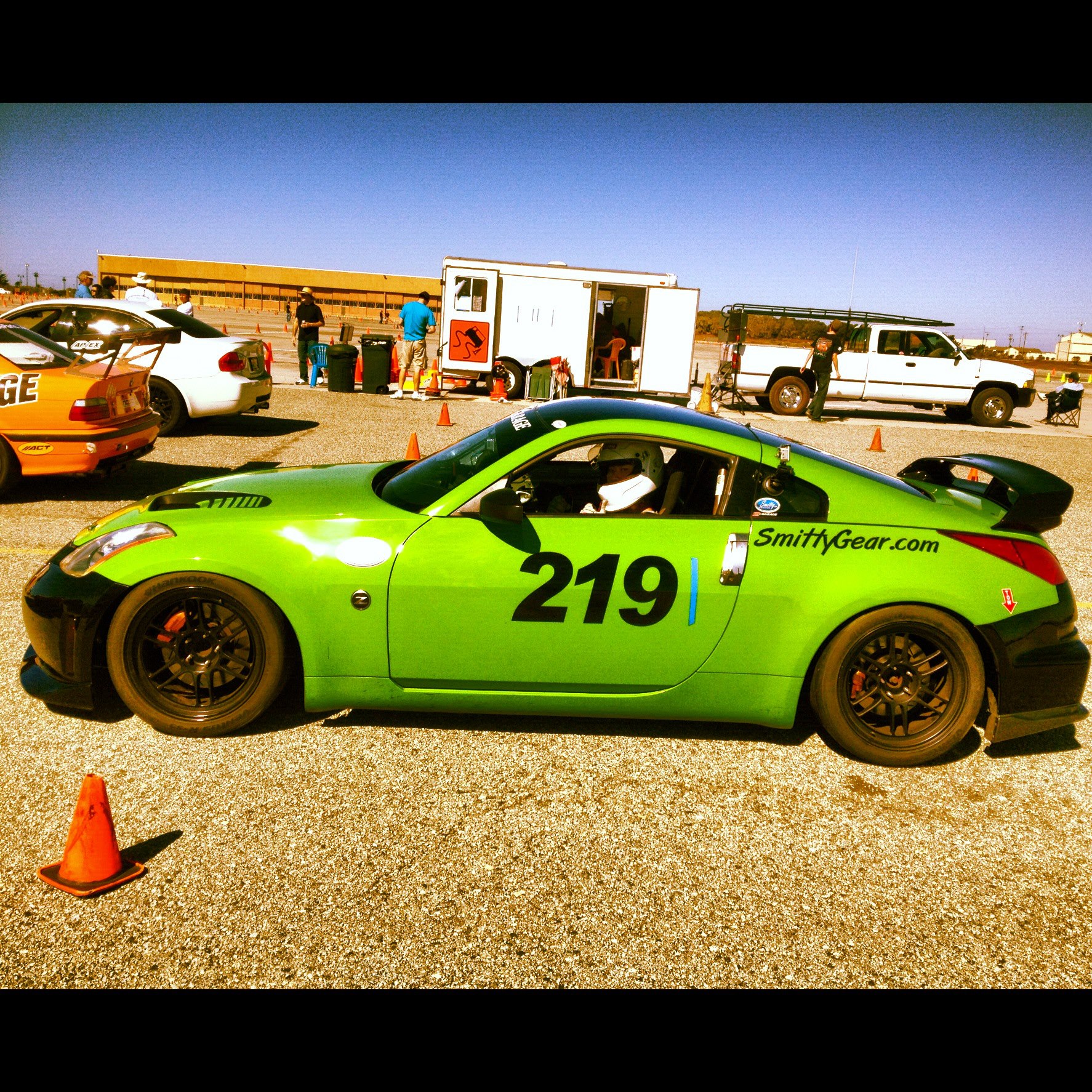

Originally Posted by the3kgt2
They're +15
It's tight and looks good, but you may get a little scuffing here and there but not bad. I had good camber, 3.2ish degrees, in this pic, and the car was really low, but no major issues.
That does look good (and very tight) but you're running a lot more camber than I am. Are your front fenders rolled or cut? Since I currently have my 285's mounted on my rear 10.5" wheels, I might try swapping the wheels up front to see if they rub before mounting them on my 9.5" wheels.
No rolling done. You can test fit with the 10.5s, but you'll have more overall width and tire geometry than the 9.5s.
