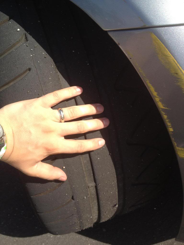

when i remove the spacer, everything ok. but the car look awkward coz in front there is also a 15mm spacer.

Remove the fender

You do know that spacers are made in different sizes, maybe order a 10mm to keep it from rubbing.
So how well are your fenders rolled?

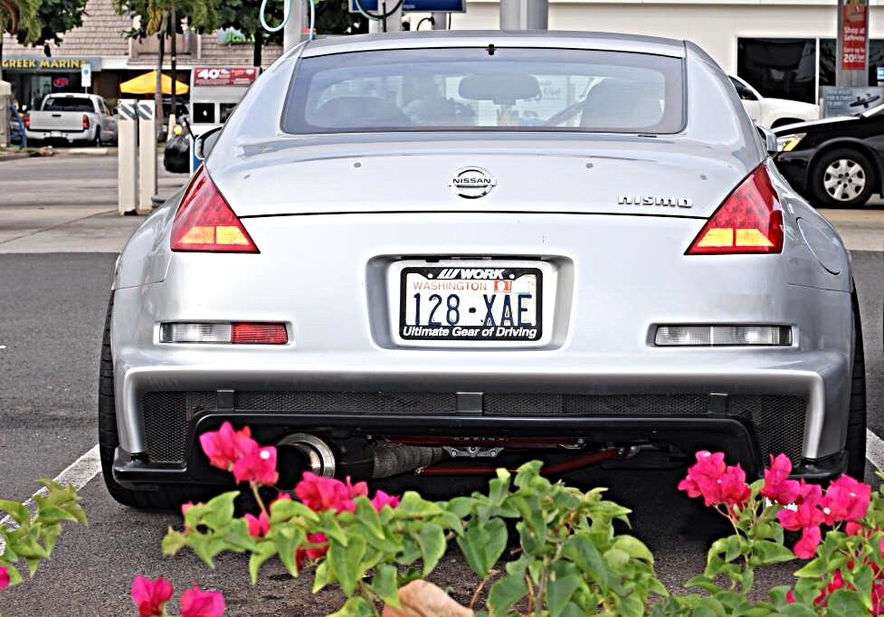

Can I play? 295/35 17 all around on 17x10 ET18
Soon to be replaced by 295/30/18 with 17x10.5 ET15 due to lack of tire choices in 17s.

that actually looks great. what are the weight of the 17" RPF1s?

meaty yes however i do not like. Kudos though

Claybar and rub compound that scrape lubo

Those are old pictures. Car is pretty much Auto-X/HPDE only. I keep it registered and insured just for ease of driving to events. That scrape got taken out last year.
Thanks they are around 17 lbs.
None of the mods done to this car were for looks. too bad I don't have any pictures with stock suspension as with the shorter tire the wheel gap on rear panel was equivalent of most SUVs
kept a 5mm spacers and no rubbing. so i guess changing the tire to 285 with a 10mm spacer will be perfect.
i didnt roll the fenders.

Roll the fenders and be done with it.

Those tires won't fit.

Meant to say 18x10.5 et15. I've been running 17s for the longest time and it is my first time in like 5 years that I am buying 18s so it will take some time to adjust

295/30/18 will be hard to come by sans Hoosier. 285/35/18 RS3 is perfect, IMO.

Stepping up to R-comp after 5 years. I want something that I can still drive on to events. Will be either Michelin Pilot cup or Toyo 888
