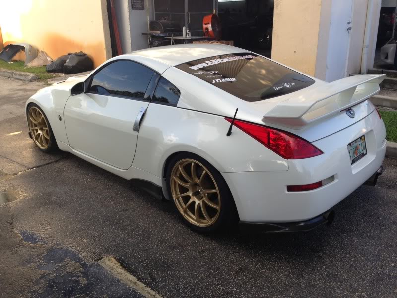

Originally Posted by Stinky EK
I've been wanting lately some 9.5 F / 10.5 or 11" R +15/+15 with at least 285
but i don't know if it'll fit ok (I got no problems rolling fenders)

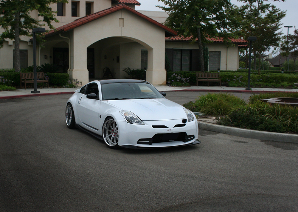

I have both 10.5 +15 on 285s (not pictured) and the ones in the pic are 19x11R +10 on 275s. With a mild roll I still have room to spare on either set of wheels.

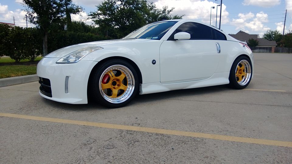

Default wonder if my Z qualifies
Running 275/35/18 on the fronts and 295/35/18 on the rears +12 offset all around

Nice homie!

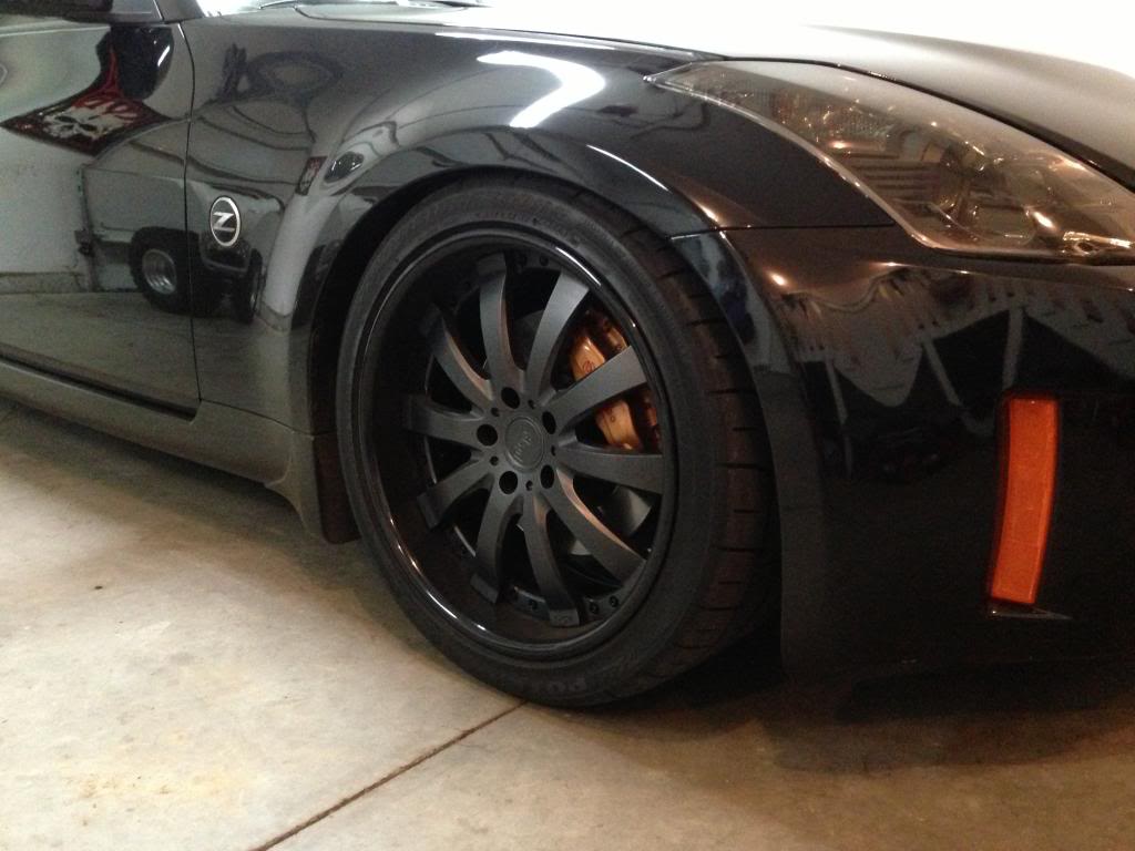

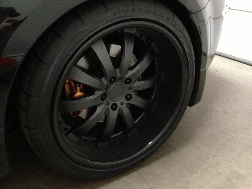

I need a 10mm in the rear...
19x10 +25 square 275/30/19 front 305/30/19 rear.

thanks man! ordered some parts for headlights mods and then install should be coming quick right after
Your car looks like it has a mustache.
Wheels are on point though.

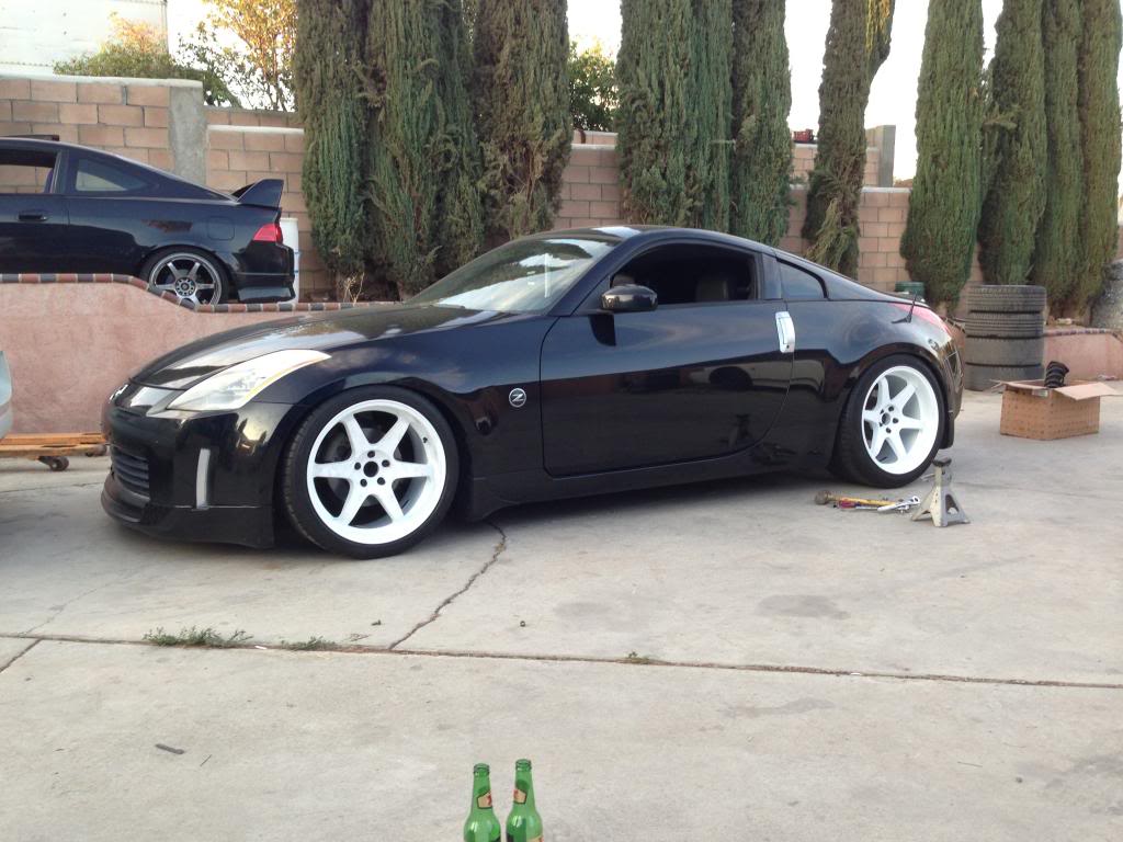

Quick question do most people take out there fender liners? i am going to have to but is this the common practice just curious. Thanks
mine 19x9.5 19x10.5 +12 255/35/19 285/35/19

I haven't taken my fender liners out, only the bolts on the top of the front fenders.
Your setup looks good! Exact same wheel/tire spec as me. What are you lowered on?

Yea...you don't have to remove them just trim a box into the top of them so that the wheel doesn't continually rub against them...

im on ff type 2 coilovers ok so i am going to try that today then cutting a box and taking out those bolts thanks alot.

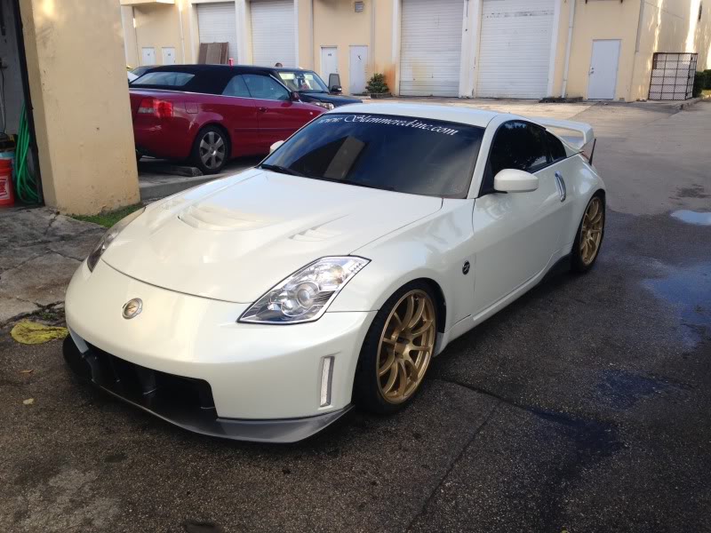

heres some shots i took the other day.
http://www.flickr.com/photos/j-franco/9374710166/http://www.flickr.com/photos/j-franco/9374710166/ by http://www.flickr.com/people/j-franco/
http://www.flickr.com/photos/j-franco/9371932949/http://www.flickr.com/photos/j-franco/9371932949/ by http://www.flickr.com/people/j-franco/, on Flickr
http://www.flickr.com/photos/j-franco/9374706104/http://www.flickr.com/photos/j-franco/9374706104/ by http://www.flickr.com/people/j-franco/, on Flickr[/QUOTE]
0 offset (after spacer) 245/40/18 18x8.5 front Nitto NT05 285/35 rear NT05 +5 offset Rear 18x10

Very nice Colombo!!
