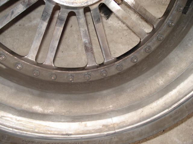

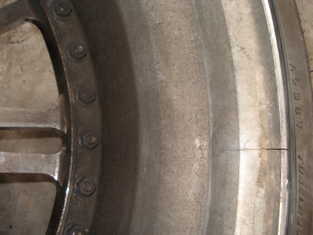

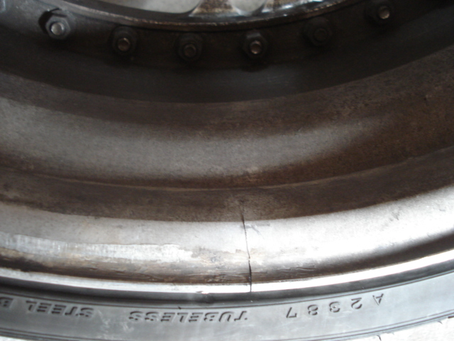

One of my front rim has a 1 inch hairline crack, please advise me is this is safe to drive on, is it safe to drive on even if i got it welded or however they fix this kinda crack.
They are asanti rims, suppose to be very strong but this one cracked.
Please let me know what can be done or if i can use it with that crack.

That is a stress fracture that you can see. What about the ones that you cannot?

I agree with everyone else, call Asanti and tell them what happened. Hopefully as a minimum they will offer you a discounted replacement wheel, if not for free. Of course, what's to say the new wheel won't crack the very same way?
Do you remember what happened to make it crack?

Not sure what cracked it, i just noticed it, i'm thinking a pothole.

And what about the other dimension of THAT crack that we can't see? Cracks grow when further stressed. . . K1c.

I had a cracked rim on my old car, bad enough so the tire wouldn't hold air. I took it to a welder (had to, it was a discontinued rim) and it took him 15minutes, and $25 but he cut the crack completely out, and welded/sanded a new piece in. I drove the car like that for 10k+ miles with no problems. The weld was probably the strongest point on the wheel, so I would not be afraid to have a welder fix it if you can't purchase another one just like it.

on your last image, there's a nick or gouge less than 1/2 inch from the crack. When you hit the pothole, if your tire's profile is short enough that allowed pavement to contact the rim, then you really cant blame the wheel. I would expect a bend, but there could be other factors, like perhaps you hit it during the winter when it was really cold.

your tires.. what size are they and what width rim do you have them on? the tire profile seems very very very small.
