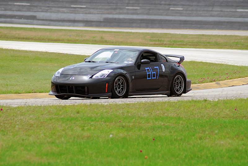

Here ya go, pics on a Nismo just for you!
EDIT: BTW, he built his Nismo for tracking and does so regularly. They are 17's, iirc.

Heres another pic of his ride for u:
Who says 17" track wheels have to look bad?
