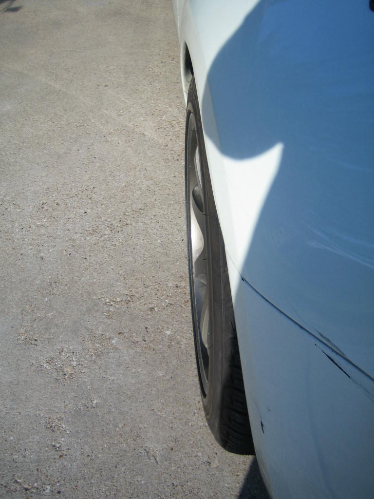

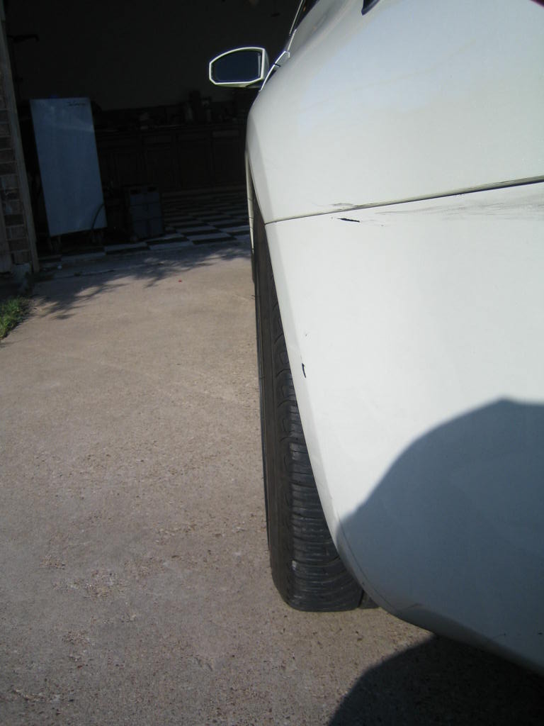

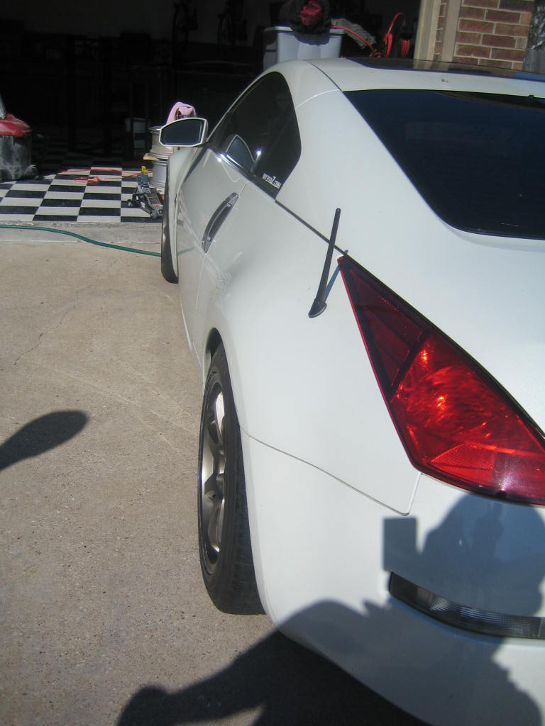

Originally Posted by Miggz
Do you have any side shots available for viewing? I am considering on purchasing a similar set as these, for track and everyday use.
Due to drifting..........i currently have MB Weapons 17x9 +27 offsets in the rear with 20mm project kic's spacers!
Fronts are Mb weapons 17x9 +17 alone, no spacers.
-J
