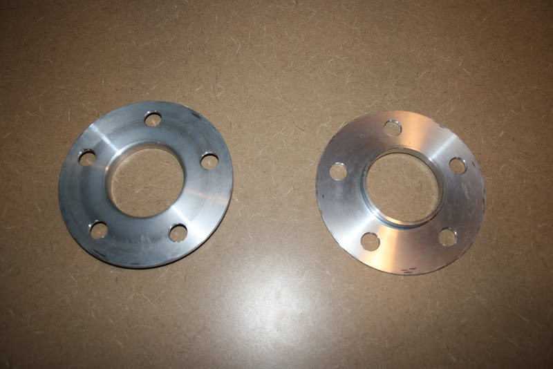

So, my +12 TE37s came in, and I needed a 3mm to clear the factory brembos. I thought I could just find a universal 3mm at any autoparts store, well not here locally. I ended up with a cast 5mm as a temp solution until the Motorsport Tech ones came in.
So glad I have the custom ones now...
Painted them black... perfect fit over the hub! Perfect fit inside the wheel, also.
Huge improvement over the cast universal ones...
Probably could have left it bright aluminum, as you can hardly see it once mounted.
Thanks again for the link, HXS!

sweet.........thanks for the pics......

looks great! glad i can help!
it's funny cuz i ordered 4-mm from them and they just arrived last week too!
looks like you got ones that are centric to your rims. mine are just hubcentric to the hub. i didn't take pics though
a bit pricey but well worth it!
