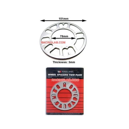

I'm not sure what makes those the "best" quality - it's a cheap, cast universal spacer, just like the ones you can get at virtually any auto parts store
