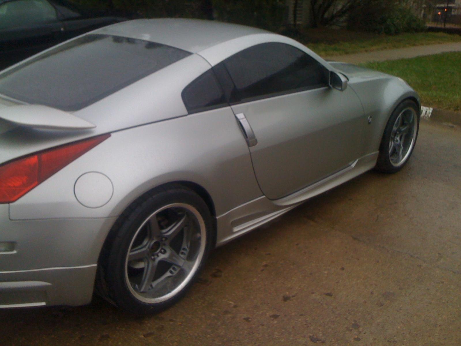

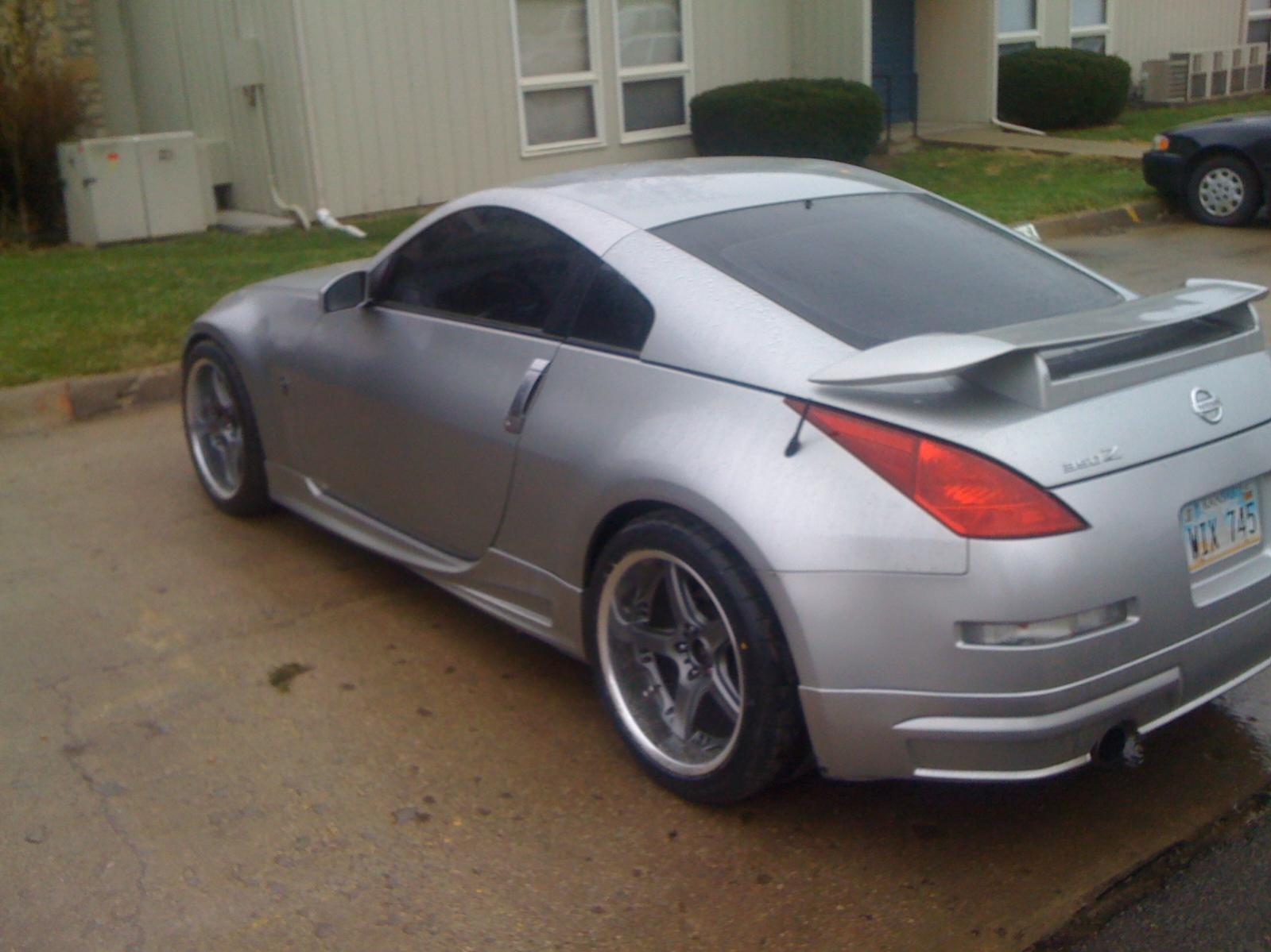

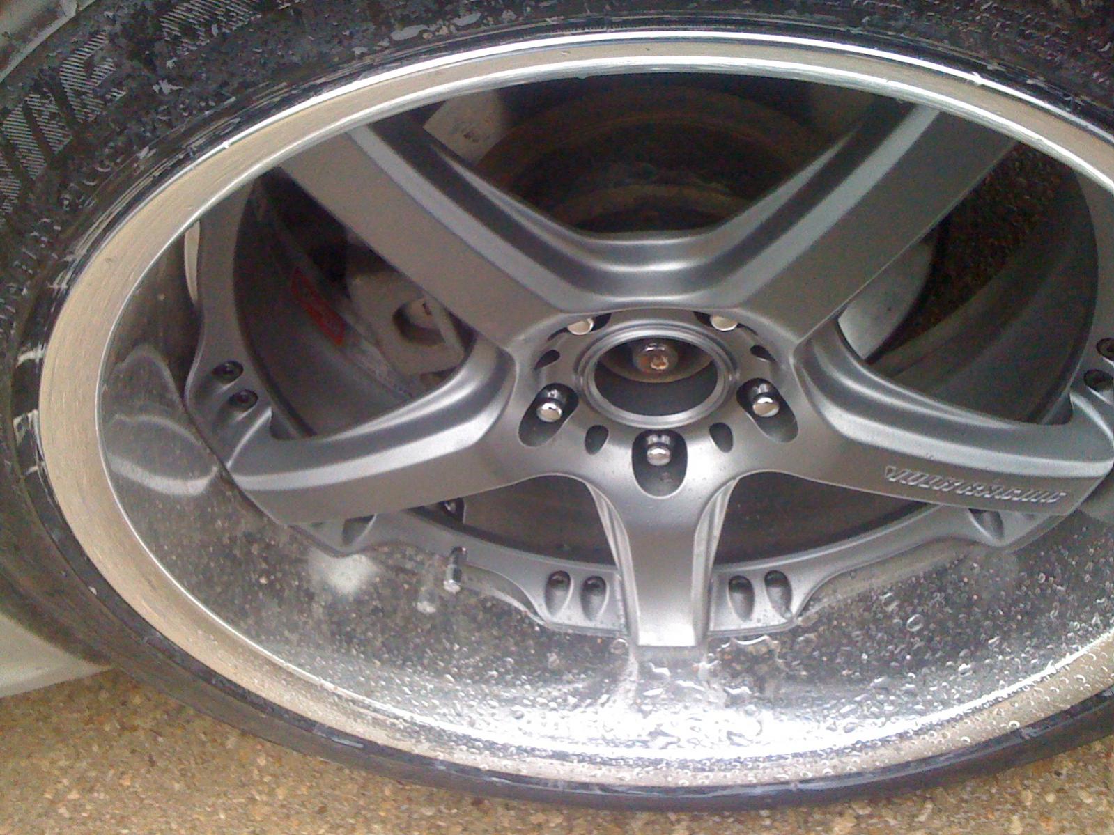

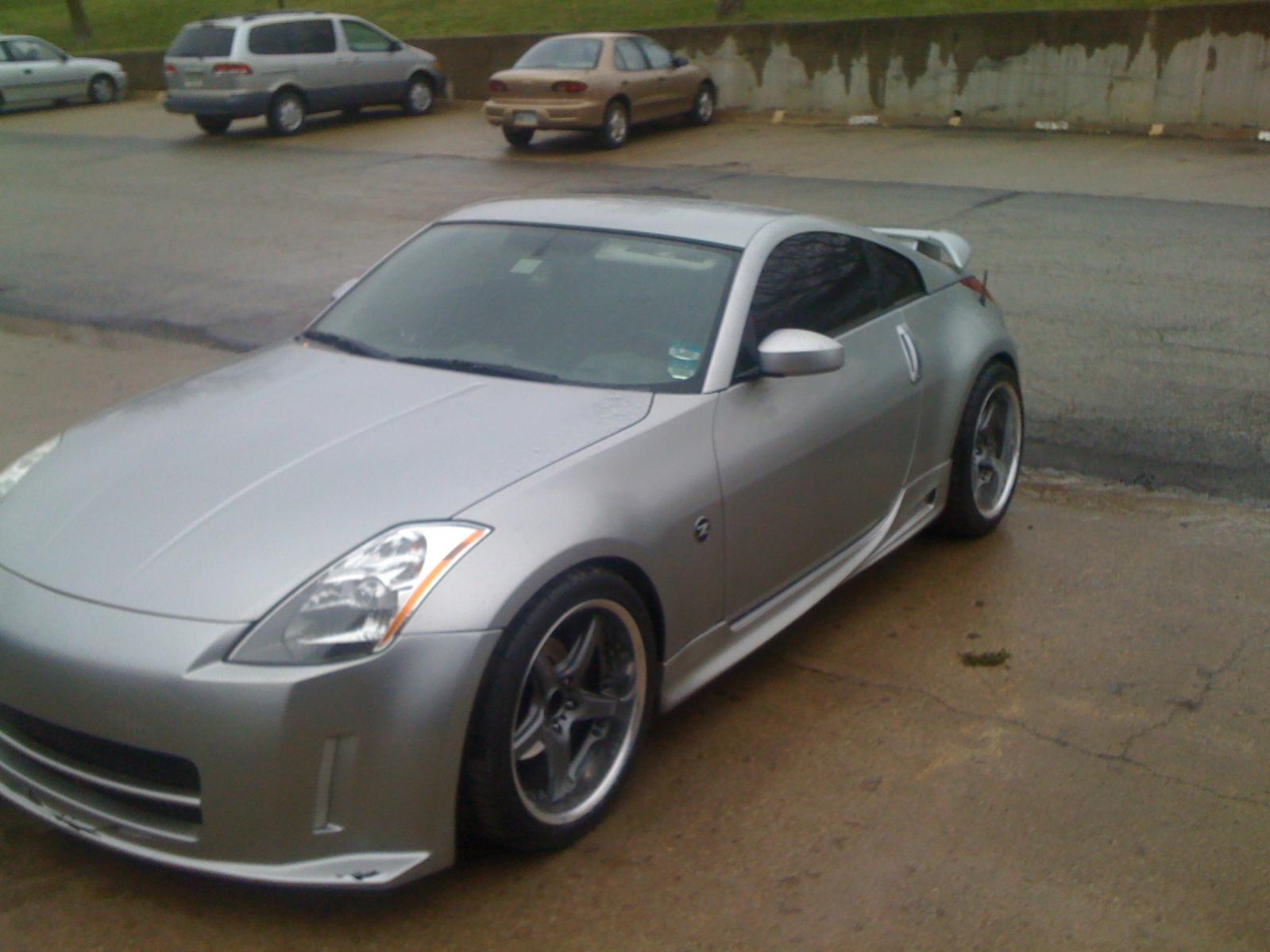

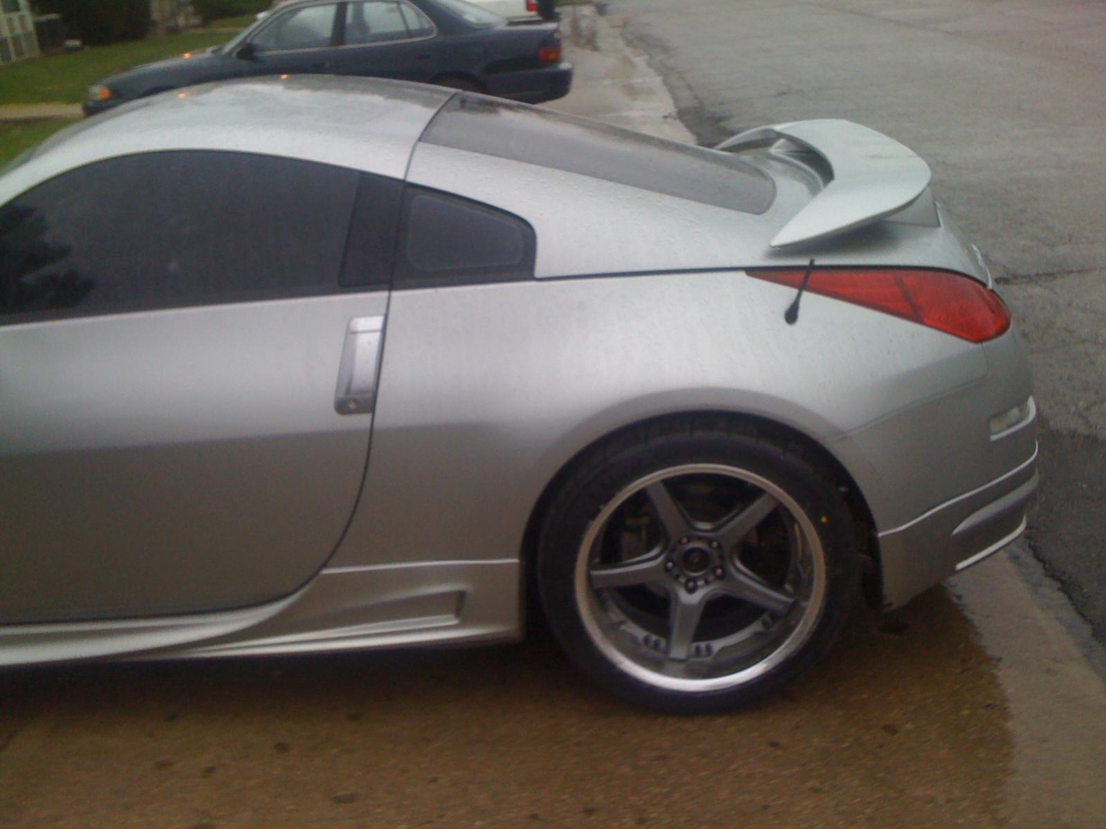

I have 19x9.5 +14 front and 19x10.5 +8 rear with 285/35/19 tires all around. I am rubbing in the rear, but I have not yet rolled my fenders (waiting for may when I am out in Norcal) I have not dropped yet, I just got my Megan Racing Street Series Coilovers, and I have not installed the camber kit, eibach and ichiba...so after all that I plan on having no rub issues, and having them sit more flush!
