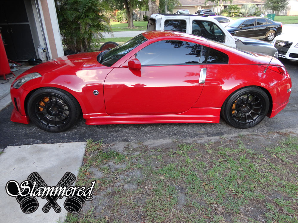

I am running 285/35 michellin pilots all around.
Prob going to a 305/35 rear and 275/35 front next time round.

what kind of bbk is that?
Old Jun 2, 2011 | 07:29 PM
  #50
lgear080's Avatar
lgear080
iTrader: (21)
Posts: 6,541
From: MIAMI
it's from an r35 gt-r i think
