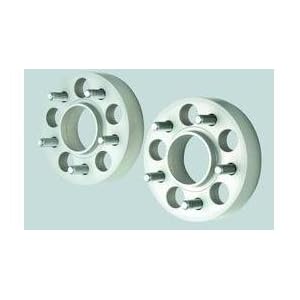

Can someone confirm this for me...
I have Eibach spacers in the rear. They are hubcentric. I just ordered new rims for my Z, and ordered a set of hubcentric rings. Now, since my Eibach spacers are already hubcentric, I probably don't need those rings in the rear, right? I'll just need them in the front correct?
Here's a pic of the Eibachs:

do you know what the hub bore is on the new rims?

More than likely, no, but whats the outer diameter of the ring portion of the spacer vs wheel hub bore?

yes you will need the ring in between the spacer and the wheel
By 'more than likely no', do you mean I won't need rings in the rear and that I should be okay? Or do you mean they won't work?
I'm trying to find out what the hub bore is, but can't find any info on these specific rims.
Ya i think so, just saw Eibach spacers are 66.1 bore diameter, or same as OEM, so youll need 66.1 to 72/3 or whatever most common a/m bore diameter is, i cant remember.
