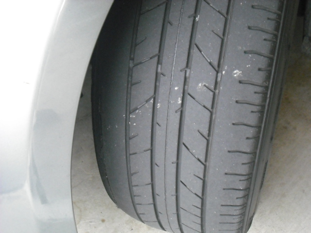

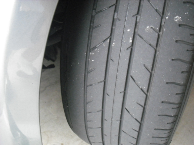

I have an 05 touring roadster, and like some 350's it has the dreaded tire threading issue! and im having the hardest time having the dealer do anything about it those ****ing ******. im thinking if im going to have to be changing tires every few years instead of buying the expensive *** bridgestone potenzas that go for around $200 each to just downgrade to a cheaper more affordable tire. i dont drag or realy push it too hard so i think ill be ok. has anyone downgraded tires because of this issue, if so what are some alternative brand names i could consider? id appreciate that help

do you have tire feathering issue? it can be fixed by getting it aligned

looks more like camber wear. get it aligned.. did you drop your car with springs or coilovers?

+1, can't see any feathering from the pictures, they look like too much -ve camber. Go get it aligned before doing anything else. May not be a dealer issue.

Thank you for posting good pictures. That reduces the guessing and provides better responses.
Looking at your pictures, I don’t think you are experiencing tire feathering. Feathering is a condition when the edge of each tread rib develops a slightly rounded edge on one side and a sharp edge on the other. This type of wear typically results in a lot of noise that is especially noticeable when you slow the car.
The wear pattern on your tires appears more like “one side wear.” This happens when there is excessive camber in the front suspension, causing the wheel to lean too much to the inside or outside and therefore excessive wear. As the other readers mention, you may only need an alignment to correct this. You should also evaluate your suspension components since misalignment could be due to worn springs, ball joints, or control arm bushings.

Agree. Up or down grade you will still have the same problem. Thraeding issue? What is that? Looks like typical camber wear to me.
Why did you NOT swap these tires 10,000 miles ago?

As others said downgrading won't fix your problem. A new set of any kind of tires (cheap or expensive, good or bad), and an alignment by a reputable shop to get your toe back into spec so you won't this bad of tire wear. You might want to look into camber arms as well so they can set it correctly when aligning your car.

thanks fellas been a great help and i feel much better bout just going all out on the potenzas now that i know what "the threading issue" realy is, and glad to hear it cuz i dont want to mess with that ish, nice!

I think the OP meant to say “feathering.”
The OP did post very good pictures that show the wear pattern to be “one sided wear” and not “feathering.”
The disturbing aspect in this discussion is that his tire dealer apparently did not identify the problem. But, maybe there is some other stuff going on here.

a. Get new tires.
b. Find a respectable alignment shop, and set front camber to -1.0 degrees.
c. Estimate the life of the new tires. Say 20,000. Swap at half that or 10,000 miles.
