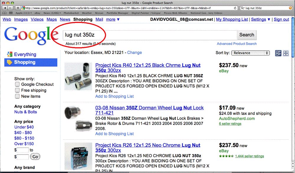

Old Nov 18, 2010 | 07:12 PM

^^^I don't think he was aking about lug pattern, Im pretty sure he was referring to length. As in mm...
