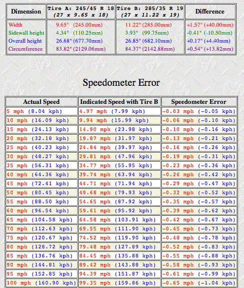

R: 285/35/19
Actual speed 100.0 MPH. Speedometer will read 103.20 MPH. This is not acceptable.

Originally Posted by davidv
R: 285/35/19
Why not? I and many others have run this size with no problems for years, especially with a 255/35 front tire.
R: 285/35/19
I think you misclicked the 30 series there.
Old Dec 3, 2010 | 05:57 PM
Spike100's Avatar
Spike100
Posts: 7,337
Likes: 204
From: Edina, Minnesota
R: 285/35/19
Are you sure about that? I think you may be measuring from the wrong series size.
The Diameter Difference is: 0.64%
Speedometer Difference: 0.645% too slow
That difference is not significant.
--Spike
Old Dec 4, 2010 | 12:01 AM
davidv's Avatar
davidv
Posts: 42,753
From: Tucson, AZ
Thanks guys for keeping me straight.
