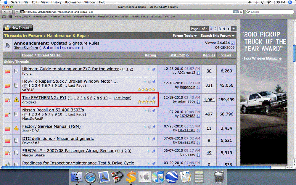

im kind of in the same boat. When i got my 03, it had pretty bad tires and i currently have it garaged during the bad weather due to all the salt on the road but when i was looking into buying an 03 i saw a thread dedicated to this issue...i was wondering if anyone had a link?(to the post on multiple proposed fixes on the 03/04 alignment issue)
