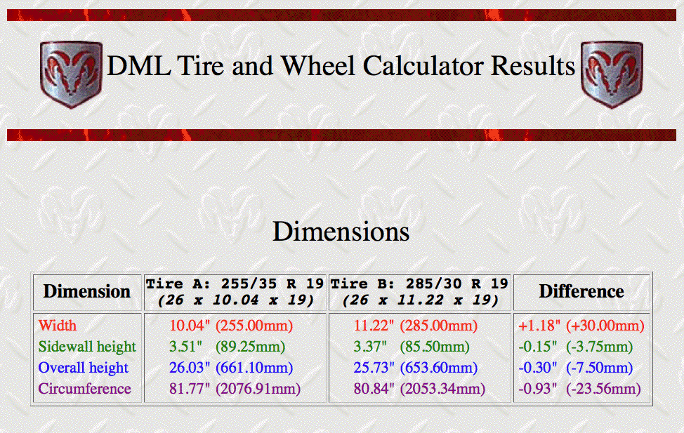

Anything wrong with running a 19x8.5 et 35 wheel up front (255/35/19) and a 19x11 et 20 wheel in the back?? (285??/30/19)?
Set of wheels i've been looking at that has been discontinued and I found a set still leftover but they are these sizes. Obviously would get a spacer for the fronts.

From more research it seems like a 255/35/19 paired with a 285-295/30/19 should fit... I hope lol

Front tires are taller than rear.

Looks like a 295/30/19 is only .06" shorter... Better than that 285 ^^
