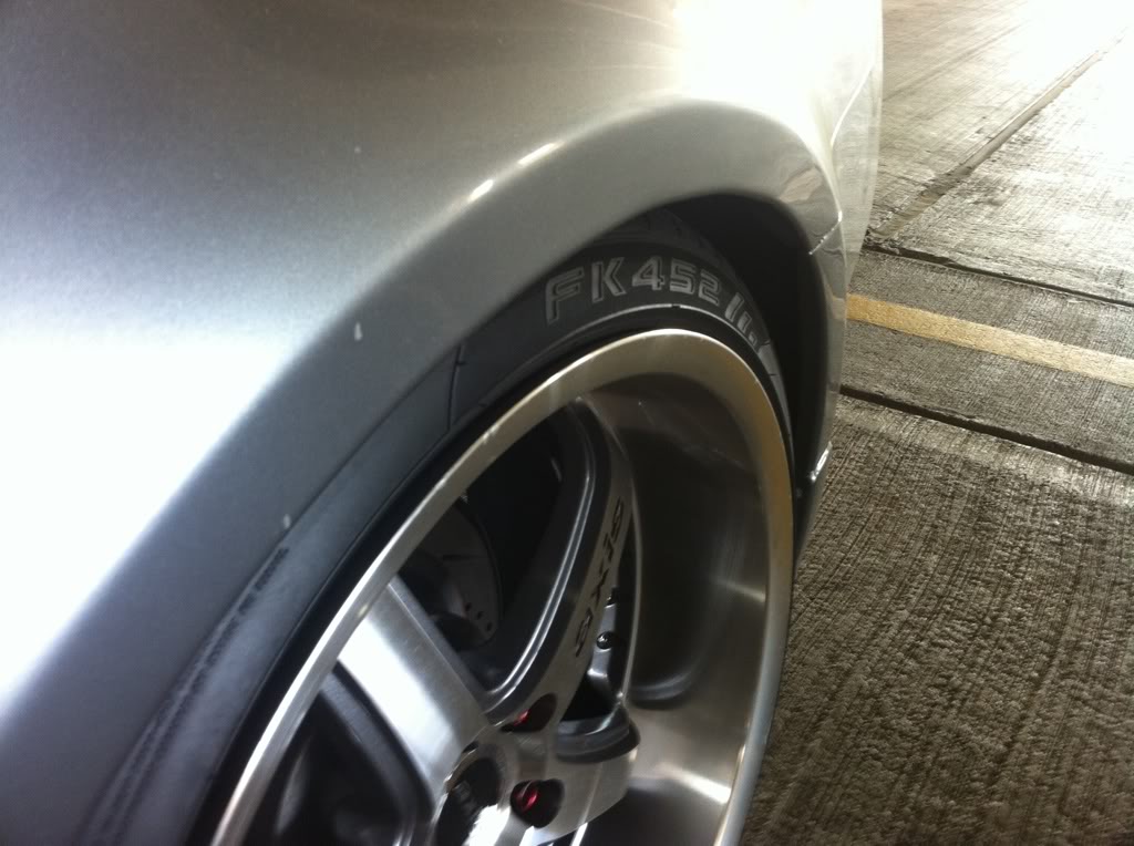

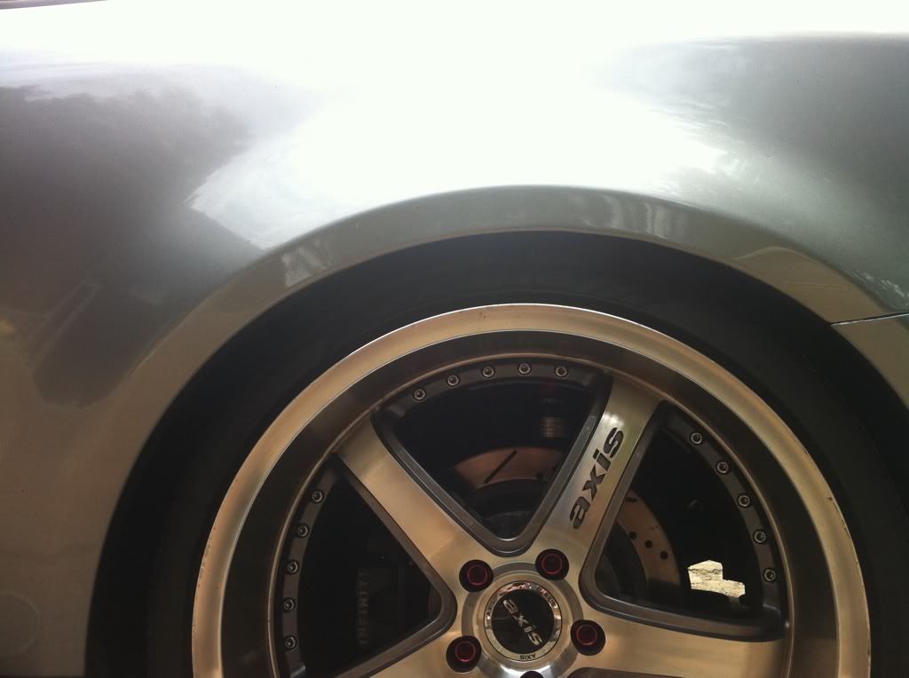

Im looking to bring the rear wheels right out to the fender, but im not sure which size spacer to go with. Would i be better off with a 10mm or a 15mm with fenders rolled? Im not sure if the 15mm will be too much. I thru on a 20mm a saved from my stockys jus to see wut it looked like before i dropped it and it looked crazy (as in not good lol). Im dropped about an inch in the back on Stance GR+ Pros. Im not looking to go too low and lose functionality of the car, i would just like a better stance. Its a G, btw for those of u who are wondering.

Looks like you could fit 15mm in there without rubbing on the fenders (assuming your fenders are rolled). What offset are those wheels?

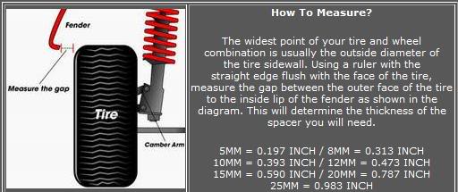

Measure the gap:

Anyone making a suggestion without asking wheel width and offset is merely guessing, which you could do on your own. Eddie hit the nail on the head assuming we don't know the width and offset. Take a wheel off, and look inside of it.

FWIW On my Z I am running 285's at +12 offset in the rear with fenders rolled and I have plent of clearance. You can definitely fit a 10mm spacer, an I imagine a 15mm would work especially if the fenders are rolled tight.

looks like you can squeeze a 15. have you adjusted your camber yet?

Nope, thats next. Im sure im a lil negative. Do ya think it be safer to run a 10? Idk if the 15 will be too close once the camber gets corrected.

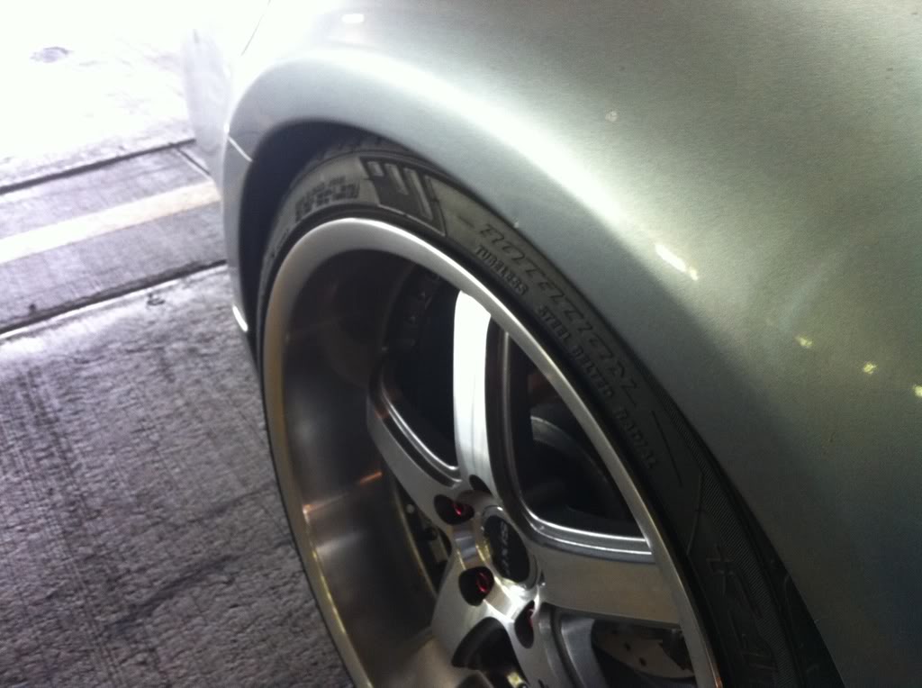

This is pre spacers!! Will update the thread after spacers/new tires/rolled fenders and camber setting are dialed in.

^^ looks good the way it is. But, am curious how it'd look with the changes you're going to make.
