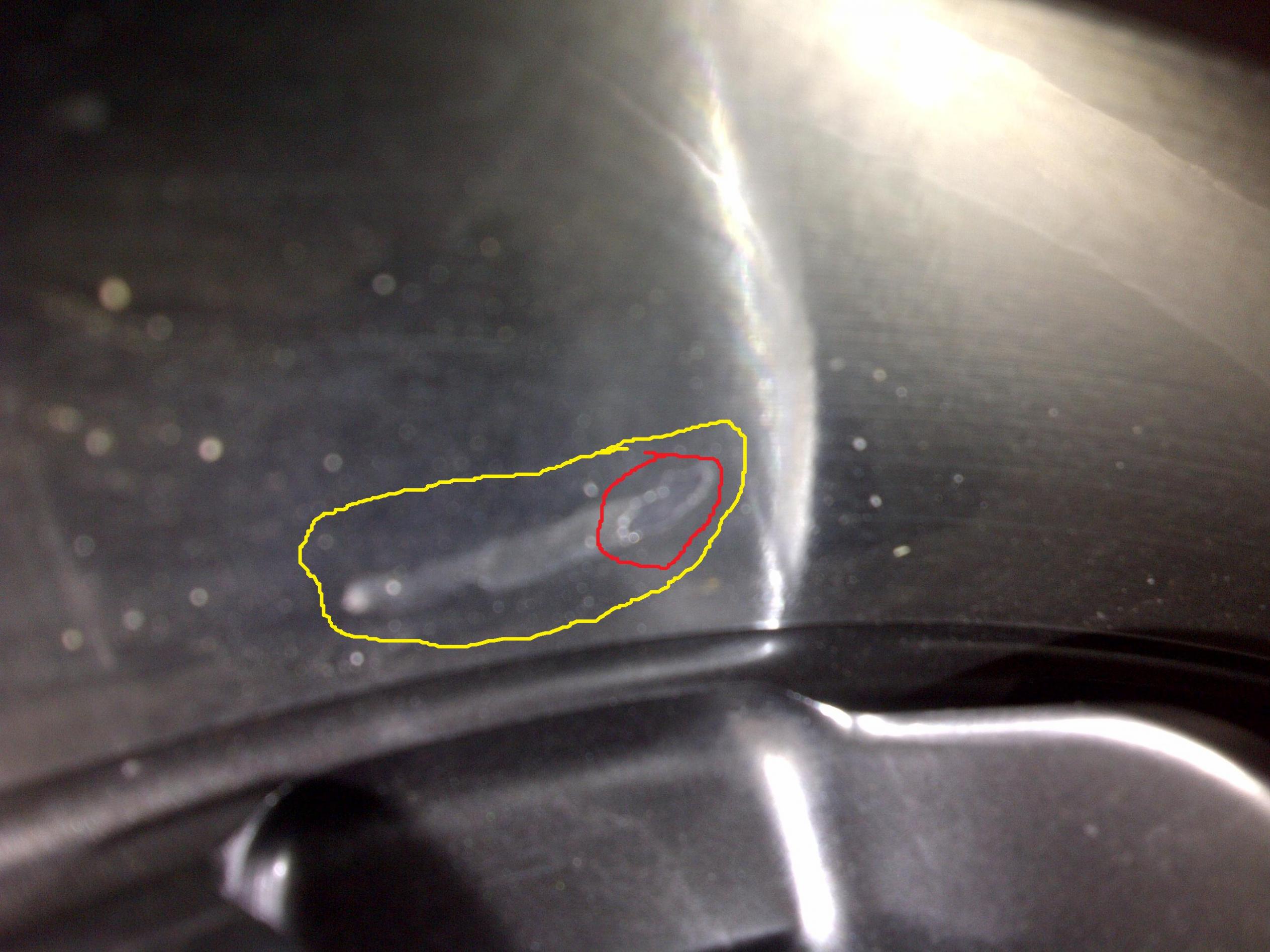

Okay, so since i brought the car out of winter storage i noticed these marks on the wheels. They are Rota SVN's, and 11-12 months old. Wheels are always kept clean and never driven on salt or winter weather (ice, snow).
Sorry for crappy cellphone pics. I quickly snapped them tonight, ill try to get some better ones up tonight.
Driver side rear: See first picture
- strange "shadow" near the center of the lip
-approx. 1 inch in length and about 3-4 mm wide - Circled in RED
-started as a brownish color. I thought it was dirt, remained after wash.
-scratched it lightly with my nail and a chunk of the lip flaked off (circled in Yellow)

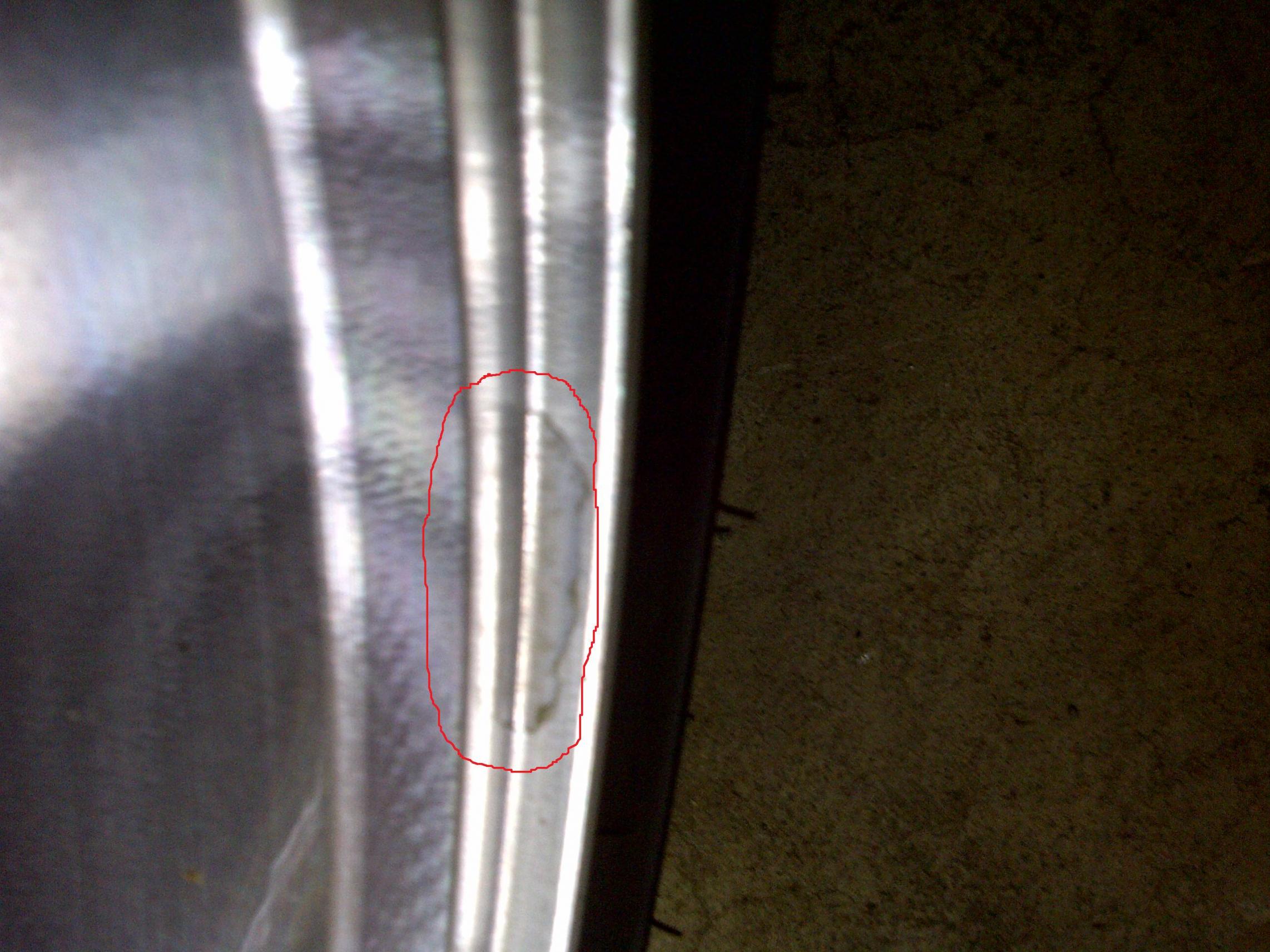

Passenger side rear: See second picture
- this one is on the very edge of the lip, no curb rash near it, and first appeared to be "tape" stuck on the rim
-approx. 1 inch in lenght, 2-3 mm wide (circled in red)
- tried washing it off, did not work
- tried peeling it off the "tape", only to realize i was peeling a layer off the surface of the lip.

1)Does anyone have any idea of what this is?
2)Any ideas of what i can do to prevent further damage to the wheels?
3)Any input or suggestions are welcome.

It is a anti-corrosive finish and will not last forever. And no you cannot put it back.

Just some suggestions:
1. Take it to a body shop to have it wet sanded gently and then cleared over the entire lip again. $$$
2. Strip off the clearcoat and polish the lip to a mirror shine. $$$ Unless it's a DIY, then only $.
3. Live with it and protect the rest of the wheel by washing then sealing and waxing it. $
4. Replace that one Rota rim. $$$

Thanks Mr. sparco. And its actually both the rears...
I think ill live with it for the rest of this year and get some new wheels in the next year..
I must say im very disappointed though. Its not like it was a rock chip that ripped the protectant off. It came up from underneath..

it happens. Especially w inexpensive wheels. The polished metal is never bare unless youre dealing w a true multipiece wheel.
You can sand it off and clear coat over it like the other guy said... but i like your other idea.. sell em cheap, and buy some better wheels later on... always good to upgrade.
